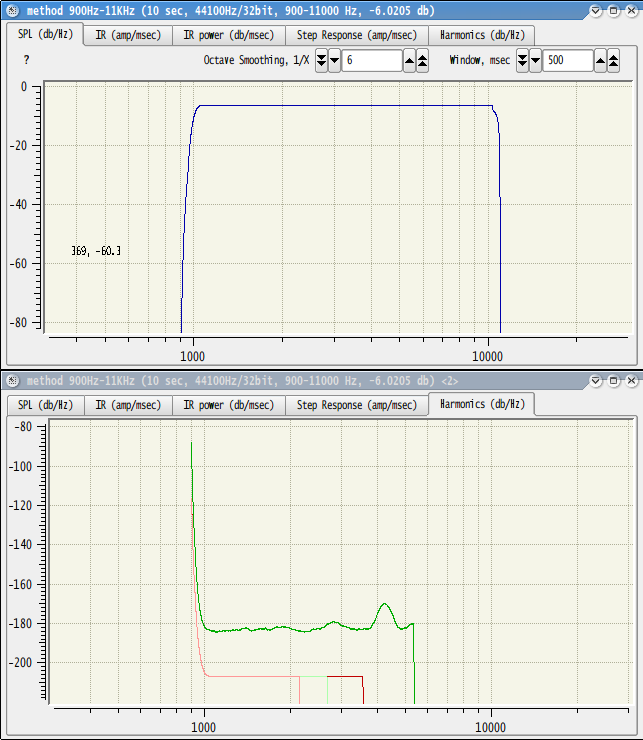

>One feature of the log sweep I like is that it's possible to define the log sweep to start at any frequency..
Actually, you can't do that with the Farina technique as described above - you need to be able to calculate an impulse response from the sweep, which you can't do without sweeping the entire band (DC to half the sample rate). You can make a log sweep that starts at higher frequencies, but you can't calculate the impulse response from it.
A better way to avoid hitting the tweeter with high energy is to just drive it through a small series capacitor, which cuts out the highs. You can easily (and very accurately) compensate for the frequency response effects in the measured result by also getting the "reference voltage sample" from the far side of the capacitor. The rolloff drops out in the calculation and everthing stays happy.

Well, it's not that you can't do it, you'll get an answer, just not a great one. Depending on how you do it, one of two things might happen: (and sorry in advance for the long-winded explanation)
If you start with a log chirp from near-dc, and gate out the earlier part from going through the speaker, and deconvolve it with the full log chirp, then the result will be as if the frequency response suddenly goes from nothing to something at the start frequency, which will give ringing in the impulse response. You can't go from something to nothing in the freq response without it showing in the time domain, and probably with a bad non-causal effect. Which isn't bad in itself if you only wanted the freq response at higher freqs and aren't going to window out any echoes. But to get from impulse response to frequency response without echoes you'd have to window (i.e., not FFT the whole IR). And if the window you use cuts into a nonzero part of the ringing, which is likely, that will add artificial ripples in the response.
If you deconvolve your chirp with the truncated chirp (the same waveform as is applied to the speaker) rather than with the full chirp, you won't get ringing but you'll probably get LF noise (low frequency ripples in the freq response), which also messes things up with windowing. The noise happens because there isn't much energy at low frequencies in the stimulus nor in the deconvolution waveform, its spectrum at low frequencies will be very low in energy. But your mic will pick up normal levels of noise at low frequencies, so the reference normalization will be dividing something nonzero and erratic by something pretty close to zero, which effectively boosts the noise way up.
[I'm assuming in the second scheme above that you normalize the measurement with the voltage applied to the speaker -- if you don't normalize (trusting that the soundcard and amp are flat enough that you don't need to remove their effects), then your impulse may actually be ok -- there is still a little energy there in the stimulus below the chirp start frequencies because of the abrupt start of the chirp, so it will be somewhat like a step-stimulated measurement there -weal stimulus, but nonzero at least. The noise at LF will still be high, but since you aren't looking to measure the LF response, no problem. Not doing the normalization will still leave some noise, but at least it won't get boosted out of sight by dividing by a small signal. ]
The main problem comes in in the windowing. If your half window cuts in where the impulse response waveform isn't zero, you'll be superimposing the spectrum of a transient that isn't there onto your freq response - sharp edges have HF energy.
There are not problems. If you use limited frequency range (with smoothing at the edges) you _know_ you use limited range and neglect artefacts at the edges. This is SPL and harmonics for 'qloud' direct connection - program output is connected to program input (it is possible to do such connection with Linux JACK sound server). So, such connection tests the method itself. Just look at the values of harmonics. I'm sure there will not be sound cards (not saying about loudspeakers) with such resolution during upcoming decades.

Values.

I mean an IR (as an intermediate form to save measurements results) changing (when we limit frequency range) doesn't have any negative effects if we keep in mind that we _want_ to get results in _this_ limited range (step response, SPL, "harmonics SPL" or something else). Pictures above show it.
