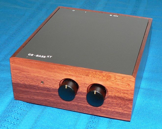

I was looking for something to add some lower bass to a large pair of bookshelf speakers (Peerless 850122 woofers) that's used secondary system. The idea was to have extra extension when playing some DVD's with good musical soundtracks (not action flicks as there's a HT setup for those). The system does not warrant a small sub, even though it had one in the past that was rarely used, so this seemed a good solution. Bass extenders I have heard in the past tended to sound like a bad loudness button.
The BassXt was first tested with a small loudspeaker that's in an undersized box where the F3 is 62Hz but 48Hz in the correct size box. The woofer is the PAE 14WG08 (Vifa BC14WG49-08) which has limited power handling so would be a good candidate to see if there would be any over driving. Not only did the BassXt restore the lower end bass, it improved on the larger box extension as well as controlling the woofer better. There were no crazy excursions and it was very well controlled. So the bass went lower and the power handling capabilities went up. The tonal quality of the bass was very good (depends on the driver of course) and natural with no boom or one note qualities. The same happened when tried with the Peerless 850122 woofer design and the F3 went from 47Hz down to well below 40Hz which is enough to enhance the selected movies where I wanted better bass from the soundtrack. This speaker now sounds more like a floorstander with a fuller sound in the bass.
In these speakers, it was not implemented to replace a subwoofer, but to extend and enhance the bass capabilities that were already there. I'm sure that port tuning (lower Fb) to give a under damped response would have even more gains but no port re-tuning was done during my tests and final use.

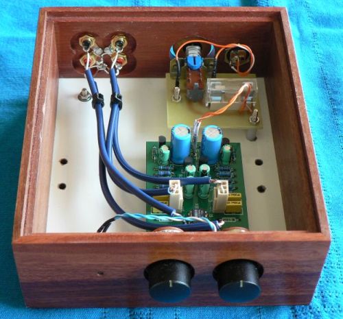

The circuit and layout is extremely simple with a 12VAC (plug pack) in, power switch, in RCA and out RCA. In the final application it's placed in the tape circuit so hitting a monitor button on the amp will put it in or out of the signal path. In the first test it was placed between the CD player and the pre amp but one will be built into the pre amp so it can be switched in as required.
I am not affiliated with the designer but I got quite excited with the results so thought this could be a great solution for those looking for a bit of extra bass extension. It worked out cheaper than a small woofer and the box was built from scrap material.... woohoo.

Each pot does the adjustment of a 6dB peak between 20 - 50 Hz on each channel to restore the F6 to flat. As the pot changes position, the resistance is changed and alters the active filter network. There is a steep sub-sonic filter that works in conjunction with this to stop the driver going nuts with too low frequencies.

I don't know how they normally sold. I ordered a kit and it came with the RCA's, some signal wiring, and a little plastic case. To finish that kit I needed a 12VAC plug pack, power input socket, fuse block, power wiring, knobs but I chose to make my own case.
