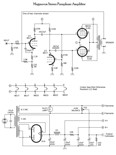

Stage 1: Schematic.
I worked up a schematic using Joel Tunnah's component images, came out pretty well I think.
I drew it with some schematic symbols by Joel Tunnah, just copied and pasted into a drawing program (I used an old one called Picture Publisher, Paint or Photoshop should work) and connected them with lines. I used the program's text tool to add labels and did a little editing to get some symbols that weren't in Joel's library (the power trans., filaments).
Not the easiest way to do it, but I like the results. You can download the symbols here: http://www.joeltunnah.com/
I used the tektronix style set.
The .0015 value is correct, in this article, http://members.tripod.com/~gabevee/maggie.html
they use an even smaller one, .0012, apparently it works.

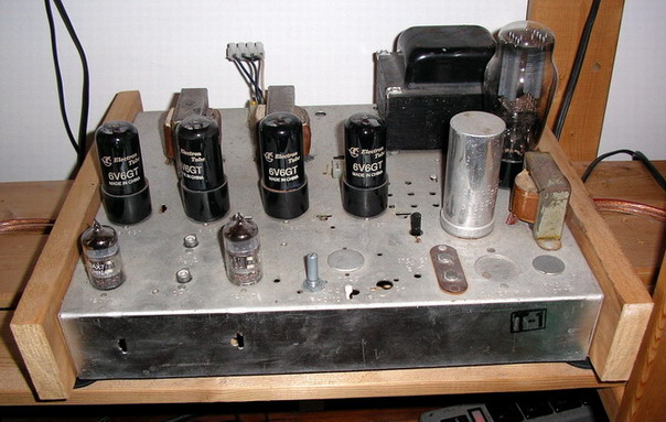

Here's a pic of what I'm starting with, still have a few decisions to make, such as should I convert it from 6EU7 pinout to 12AX7 pinout.
Also have a few options for the cathode resistor, it has one 4W 100ohm for all 4 6BQ5s, got hot enough to burn up a wire running under it.. I bought some 200 and 400 ohm 4W resistors, figure on either a 400 in each cathode, a 200 in each output pair, or two 200s parallel for all 4 tubes. Open to any suggestions.
Administrator
Joined 2004
I had one of those old stereo Magnavox SE amplifiers in high school. Had a pair of 6BQ5 and IIRC a single 12AX7 (not 6EU7) It sounded way better than it ought to have. These days I have 3 dht based SE amps and a pair of PP 300B monoblocks, that little amp was probably the start of it all, although I did not realize it at the time.. :D
I would replace the 6EU7 with 12AX7, they are electrically identical except for filament configuration and pin out which of course is totally different.. LOL The 12AX7 option will give you a lot more choices in terms of tube rolling potential. Good 6EU7 might tend to be a little more costly as well.
I rebuilt a magnavox stereo pp amp with a quartet of 6V6 some years ago, it actually sounded pretty good once completed.
Yeah, I figured the 12ax7 pinout will give me more options and be easier to get.
You can see in the pic that there's also a hole cutout for another socket, could put a preamp in there maybe, although I'm thinking of using it as an amp for my Rockman X-100 guitar amp so I'll probably just need line level.

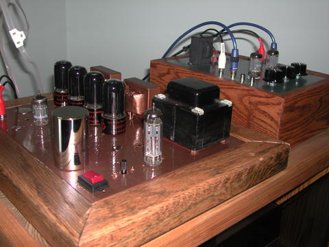

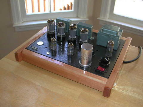

" I�m also thinking of adding wood to my amp. Hope your amps sound as good as they look. Did you disassemble and paint the chassis?"
Yep, cheap and easy to make. A simple picture frame, glued, stained, and poly'd. That is a Foreplay II, older kit. Super easy to assemble with great support from Doc.
