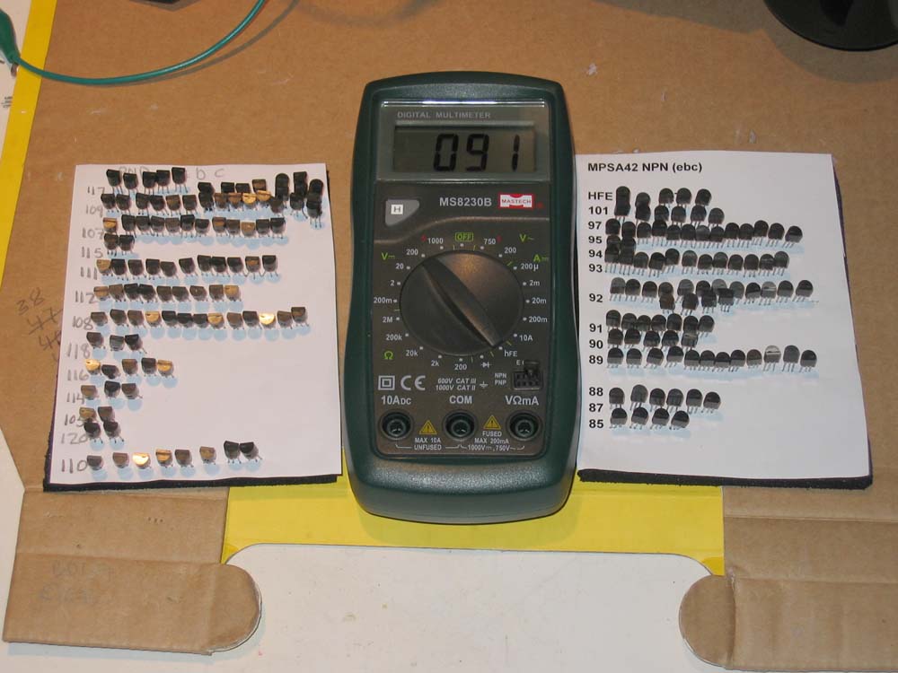

I received 100 pcs each of On Semi MPSA42 & MPSA92. I measured the hfe of the devices using a Mastech MS8230B. I also had some older National Semi MPSA42’s so I tested them too. I’m not certain of the exact circuit this digital meter uses internally for this test but here are the results. My obvious purpose was to match NPN and PNP pairs but the results were not as good as I expected.
I am very interested in hearing your comments as this is the first time I have done this type of measurement.
Shawn.
On Semi MPSA92 PNP
hfe - QTY
120 - 2
118 - 3
117 - 5
116 - 5
115 - 2
114 - 3
112 - 9
111 - 11
110 - 8
109 - 24
108 - 13
107 - 12
105 - 2
On Semi MPSA42 NPN
Hfe - QTY
101 - 5
97 - 6
95 - 13
94 - 2
93 - 12
92 - 17
91 - 7
90 - 5
89 - 12
87 - 6
85 - 4
65 - 2
64 - 1
53 - 2
48 - 1
47 - 1
46 - 1
38 - 1
35 - 1
hfe - QTY
274 - 1
252 - 1
246 - 1
226 - 1
129 - 1
114 - 1
97 - 1
87 - 1
85 - 1
74 - 1
57 - 1
56 - 1
50 - 1
47 - 1

you have demonstrated the reason for which National Semi no longer sells discretes.
fwiw -- i often see a bimodal distribution of hfe, vbe for BJT's and vgs for Lateral and vertical MOSFETs.
jackinnj said:you have demonstrated the reason for which National Semi no longer sells discretes.
Jack, that is funny😀 and could you explain bimodal?

Do you bother with hfe or is Vbe more important? I see Leach suggests matching current gain with a little circuit to lower DC offset. Also setting up a curve tracer circuit with a scope is an option too.
I want to match as best as possible, not perfect but good matching. I admit to be a little confussed by the different methods that can be used to match.
Jack's double humps of hfe just throws a wrench in the machine.
Shawn.

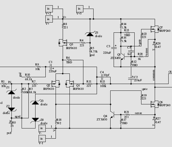

If looking Nelson Pass amplifiers, we can see he prefers non-symmetrical designs, with a few exceptions.
Myself is also a follower of the normal left-right logically better symmetry concept.
Aleph has long been the Top Of Line of Pass amplifiers.
The symmetry used, is more left-right symmetry that is provided by the input pair.
And not any vertical, NPN-PNP, so called symmetry attempt.
I attach an Aleph-mini amplifier schematic to show this.
lineup

Near day, I don't use big load for input stage longer and offset is a problem. I chose and matched tst 2N5551/2N5401, and I feel very comfortable 🙂 although I don't use any extra component.
Yes! Offset voltage can destroy our speakers. You also should study a DC protection circtuit to sure your speakers which never "burn" 😀
TomWaits said:So the hfe of the PNP does not have to match the hfe of it's complimentary NPN? Is this true?
Shawn.
My Understanding is that it is more important to match like devices with like devices. match all the NPN's to each other and all the PNP's to each other.
I have been asking the same questions related to this recently and and found more questions then answers actually. I have a much better understanding of the process but now i have even more questions! Isnt that always the case? the more you learn the more you need to know.

Certainly and as thanh says, the different topologies may influence the method used to match devices or even no matching at all? I would like to understand why like devices are matched and not complimentary sets of NPN and PNP. I wish I could get my head around that. 😕
As you can see from my measurments it may be a good idea to test the devices anyway to sort out the odd ones?

IMO the important thing is to get a symmetrical output signal(including clipping) from the "black box" that is the amp. If the amp is symmetrical or not in circuit topology make no difference to me. The last circuit I built is asymmetrical(I guess this puts me in the 'Nelson' group.😀), Av is 65. The Vgs of the input transistors are matched near perfect(took a large sample to find these🙄 ) and the DC offset is +18mV with no offset adjustment even in the topology, only 1 pot for Vbe mult. I made a second channel but used a very slightly different Vgs(still within 5% or so) and offset is +29mV. This offset is
OK, but it does illustrate the importance of matching certain transistors depending on how they are used. No doubt that if I just grabbed two from the package, the offset would be significant given the typical variance in jfet Vgs.
CBS240 said:The Vgs of the input transistors are matched near perfect(took a large sample to find these🙄 ) and the DC offset is +18mV with no offset adjustment even in the topology, only 1 pot for Vbe mult. I made a second channel but used a very slightly different Vgs(still within 5% or so) and offset is +29mV. This offset is

I also noticed, that these transistors are nearly identical just as you buy them. Hfe variations are around 10-15% and values are very similar between pnp and npn.
P.S. It is sometimes more important to match Vbe. I do it by diode-testing a b-e diode and multimeter displays voltage drop.

darkfenriz, do you care much about hfe in pre/vas stages? Or does it all depend on the topology? Sounds like a huge factor?
Shawn.
