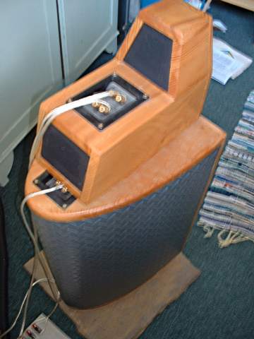

Spherion
Ok, I use a separate mid /hi enclosure and it works brilliantly, ( see photo below, only a back shot, but I left my camera at work!)
For Bass drivers, If you can afford them I would reccomend the Volt range, especially the B2500.1, or the RV3134, which not only sounds good, it looks really cool as well:)
Thanks Al for the photo, it really looks amazing.
How did U made these slanted(sorry if I used wrong word) walls?
My idea was very similar to your but with more ordinary shape
of the speaker cabinet.

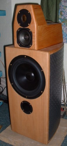

Ex-Moderator
Joined 2002
Just noted you started another thread without me;)
The sloped walls on the mid/hi enclosure are done with a table saw, and much thinking about compound mitres:xeye:
The eliptical rear on the bass box was made of a lamination of thin mdf, concrete, and finished with a layer of vinyl flooring to give the checker plate metal look. It is very rigid, and with the different materials used, very damped.
I think a tweeked Volt is used in the REL drivers.
Found a front photo buried on my HD
(edit) I think Volt have both Swedish and Russian dealers, could one of them be cheaper?
