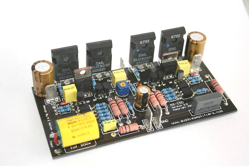

Hi guys,
Here's a gratuitous pic of my new amp - a little 50W lateral MOSFET design destined for my study. It's essentially the same topology as my 100W one (in turn based on David Tilbrook's AEM6000), but I've taken advantage of the lower supply rails (+/-40V rather than +/-56V) and used MMBT06/56s in place of many of the MJE340s and 350s. It also only uses one pair of 2SK1058/2SJ162 lateral MOSFETs.
It simulates very well - 0.0005% THD at 1KHz (50W into 8 Ohms), and 0.004% THD at 10KHz (50W into 8 Ohms).

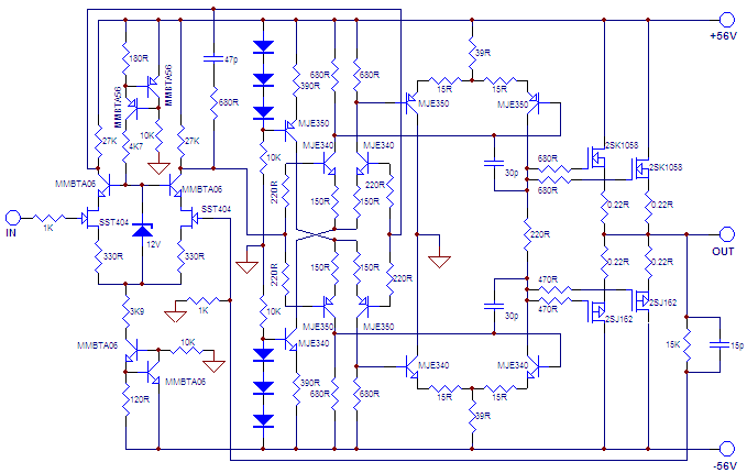

fluckscapacitor said:can you post the schematic?
Ask and ye shall receive: http://www.littlefishbicycles.com/poweramp/50W_amp.pdf

Yes, what exactly is the total vertical height including any required stand offs or insulators?? (Will it fit inside a 1U rack mount chassis?)
A heat sink not required ?? (or is there some more parts we can't see yet?)

fasteddy,
from what I can see the mosfets are under the holes between the power caps......then the board mounts on the heatsink much like the P68 or P101 amps from ESP. 🙂

@suzyj
It seems you have a plate with an operational.
That don't "apear" on your schematics.
Could you tell us more about that?

FastEddy said:Yes, what exactly is the total vertical height including any required stand offs or insulators?? (Will it fit inside a 1U rack mount chassis?)
Kit soon? Modular amp soon?
" ... a preamp board, ..." ... ?? got a pic of that too?
It's 33mm tall. 5mm for the MOSFETS (under the PCB), 3mm for the PCB, and 25mm for the filter caps. It'll fit easily into a 1U box.
The heatsink goes on the back. a pair of bolts go through the PCB, through the MOSFETs, and into the heatsink. It's a similar arrangement to what I did with my 100W amp.
Dunno about kits. It's too much of a derivative of Tilbrook's work for me to make money from.
The boards are designed but yet to be made for the preamp. It's a fairly simple affair with switching done using SSM2404 quad switches, an OPA2134 as a buffer, and a PGA2310 volume control.
felixx said:@suzyj
I assume you're referring to the 8 pin SOIC? That's the SST404 matched dual JFET.

Hi suzyj ,
I've found your shematic of this amp. I wanted to say that it looks alot like my designed amp last year. See the link.
I see that you've used two diff stages, problably to have some decent gain with the JFET's?
I've managed to find an other solution to have a relatif high gain? What do you think of this solution?

" ... It's 33mm tall. ... It'll fit easily into a 1U box. ..." 😀
" ... The heatsink goes on the back. a pair of bolts go through the PCB, through the MOSFETs, and into the heatsink. ... "
So by using a simple angle bracket of aluminum (or such) you could bolt to the bottom of a 1U rach mount case = using the mass of the case as the heat sink ... 😀

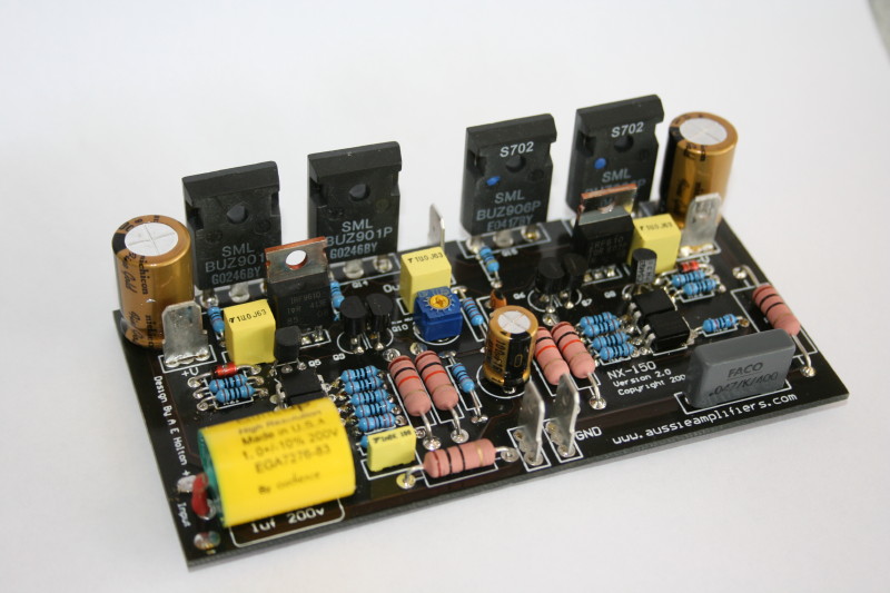

suzyj and The Saint amplifier shown
hi
I have to say both these amplifiers shown
looks excellent work.
They are for us who love amps .. like Works Of Art!
suzyj
Image: http://www.littlefishbicycles.com/poweramp/50W_amp.jpg
The Saint
Image: http://www.diyaudio.com/forums/attachment.php?s=&postid=1087540&stamp=1166738073
however they can be displayed a little bit better
This comes from the fact that when using digital camera indoors (not full daylight)
we usually have to adjust the brightness of pictures, a bit.
(Sometimes also adjust the R G B, red green blue, balance
to get closer to natural colors.)
I guess I am a bit of a perfectionist.
Because after loading my digital pictures to my PC
and before publish them here at diyAudio or in my websites,
I use my image editor program to ADJUST brightness, colors etc etc.
Take a picture of one of my circuits.
When editing image I take the actual circuit and put it beside my PC monitor,
while adjusting until image has got a suitable brighness + colors that looks as close the colors of my circuit and its parts.
After this I save the new edited copy, ready for upload / publishing.
First:
I use a freeware image converter / editor with many many features:
www.XnView.com
It has many many nice features. This is only beginning of a long list.:
An example what can be done when you adjust and edit pictures.
The Saint, AussieAmplifiers.com
Attached image of amplifier:
If you compare this to My Attachment of Edited version of same Image
you will even be able to see, that IRF9610 and probably IRF610 is used
to drive the BIG MOSFET (absolute! top class BUZ901,BUZ906 Lateral MOS)

" ... they can be displayed a little bit better. This comes from the fact that when using digital camera indoors (not full daylight) ..."
Yeah, but then everyone could see the TO3 can part numbers ...
