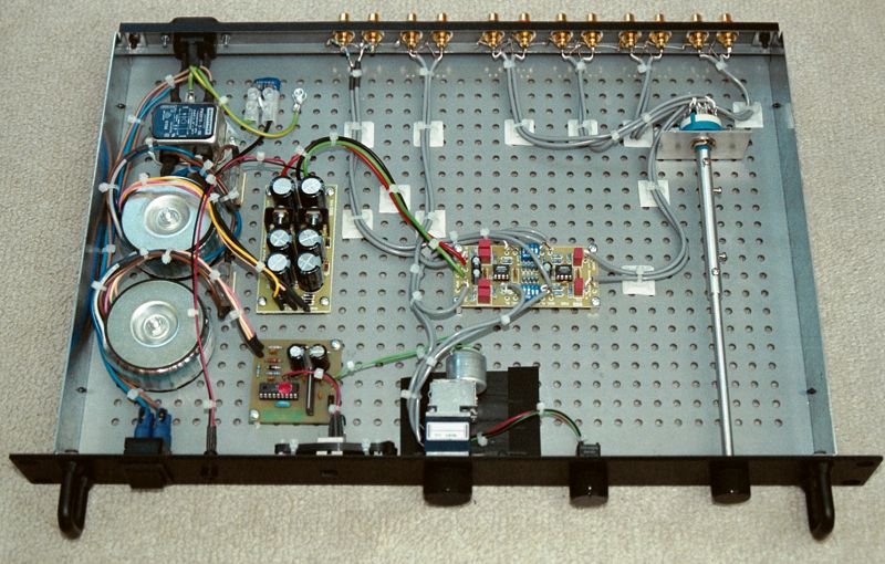

A couple of people have emailed me asking for pictures of my Elliott preamp, which I completed over the summer. I only just got my pictures developed, and I decided to post a few of them here since I enjoy seeing others work - particularly some of Peter Daniel’s creations!
Here is a picture of the inside of my preamp, which I built into a 1U rack case from Maplin Electronics. I am using Rod Elliott’s preamp and power supply boards, and a remote control board whose layout I designed. On the right you can also see one of Rod’s rotary shaft extenders. On the left, there is one toroidal transformer for the remote control, and one for the preamp itself (this was not for noise reduction - I couldn’t get the voltages I needed from one component). The Alps volume control pot was from RS components, and includes a small motor and gearbox, which is driven by the remote control board.

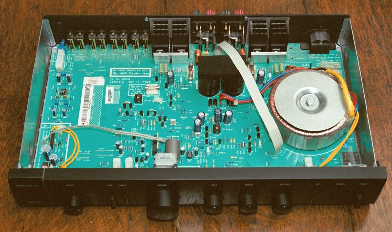

I pinched the circuit for the remote control from the service manual for my dad’s Arcam Alpha 6 integrated amp - that way I was sure the control would work with my Arcam CD player handset. The photo below shows the inside of the Alpha 6, the remote control circuit is at the bottom left of the amp.

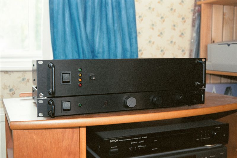

Finally, here is a picture of my preamp and power amp together. The power amp is a “double barrelled” Elliott P3A. I posted a pic inside it here:

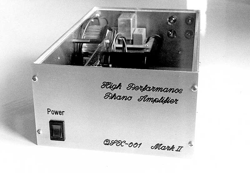

My bauta heatsink costed me almost nothing. The QSX case costed me 5 bucks. Bought it as junk from Plåt & Profil in Göteborg, Sweden.

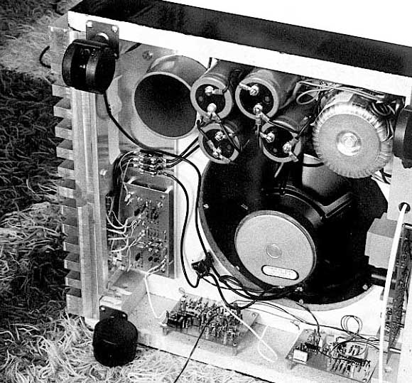

Here is a picture of the almost free heatsink, 5 kg!
Note: You have to be an expert in theory how heat is transported in materials. This heatsink hasn't got the optimum shape of the cooling fins. The cooling properties aren't so good as you could think. But the transient cooling is emormous!

trwh said:I love the way that looks, peranders. Did the case come with that lettering on it?
Did it with an engraving machine.... you haven't seen the top plate... grip fitting, 0.03 mm! This case is really solid, not like this of course but I was still pleased with it.

thats a really nice amp+pre trwh. really clean design... looks much better than most tube amplifiers

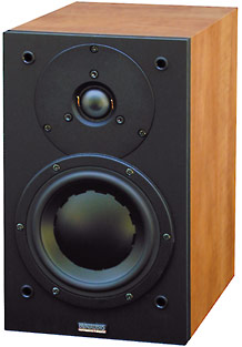

I have now got an accurate pic of my Audience 42's, thanks to Halojoy. Here it is:
