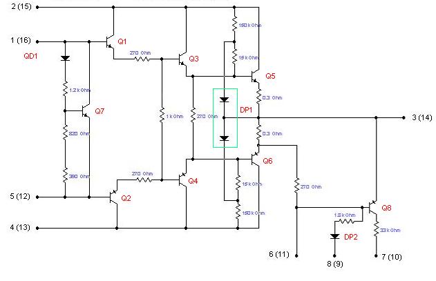

The Technics amps I have actually seen on the market
looked to be a variation on Dynamic Bias; in fact an
alternative approach to my patent #3,995,228.
Far more interesting is the amplifier based on the
1977 Sano et al patent #4,115,739, which corresponds
roughly to the above descriptions.
In any case, I pay Sano, Hirosha, and Hirota the
highest compliment: I wish I had thought of it.
Mr Pass,
could you explain briefly how technics bias is achieveing sliding mode?
Atiq
