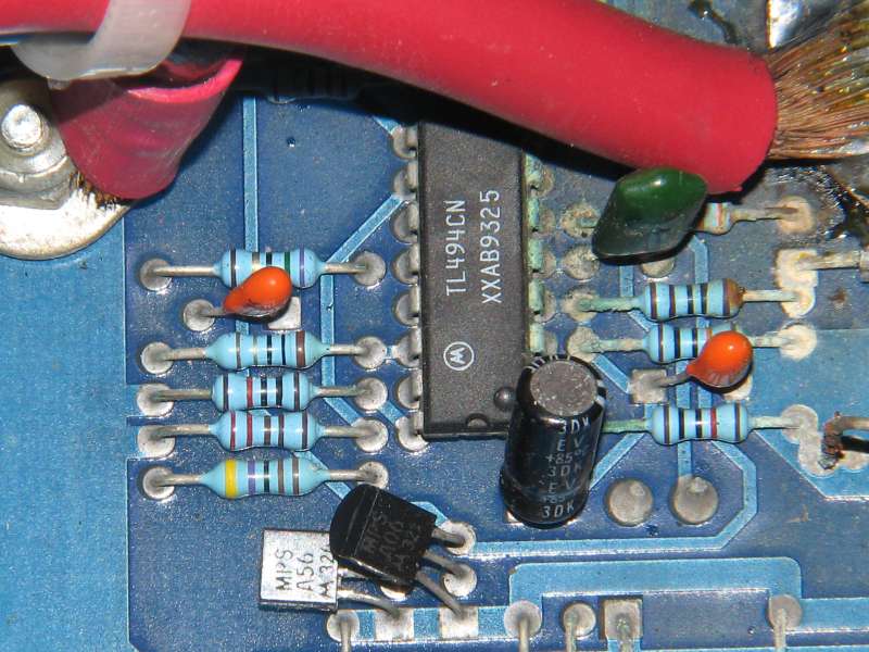

If it has a TL494 (or tl594) in the supply, you need to connect it to a power source (including remote) via a 5-10 amp fuse (nothing larger) and measure the voltage on 'each' pin of the TLx94 IC. Do not let your leads short between pins. Black lead on chassis ground. Meter on DC volts.
Look up the datasheet for the IC if you don't know how the pins are numbered.
If there is no TLx94 IC, you may need to post some good quality photos.

I'll have to get some pics for you because I have no idea what your referring to.Could you give a description of what this particular part may look like?This amp has never had any end caps or bottom plate as long as i have had it. I myself do not know what color wires apply to what speaker channel and or remote turn on lead.I know that there is the obvious power and ground cables as well as a yellow,orange,blue,and two or maybe three other black wires.It is very possible the person I got it from hooked it up wrong and hurt something.
That amp doesn't use an IC to drive the power supply and can be difficult to troubleshoot. There's a large resistor next to a small transformer near the far side of the amp. With the amp on, is there any DC voltage across it?

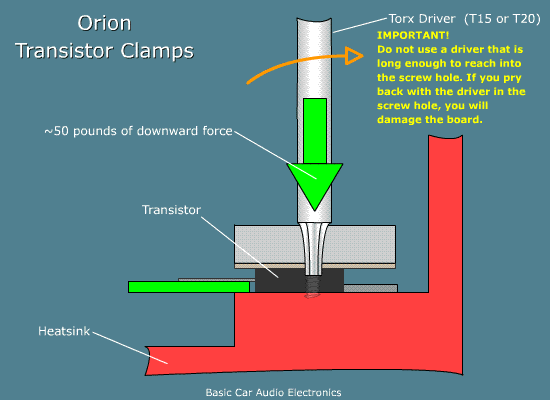

i am unable to power this amp up to even try and test voltages.I hooked up power to the amp including remote turn on and it fried a five amp fuse instantly.I'm getting continuity between the middle leg and the right leg on four transistors. They are the transistors in the upper left hand corner of this photo(its my actual amp).I can provide much better pics if needed.Will these four shorted transistors keep the amp from powering up?
sorry its a bad pic.I guess i could have taken the clamp downs off of the transistors so you could actually see something.I'll get something better when I get a chance to take it apart.
If those transistors are shorted from pin 2 to pin 3, that would cause it to blow fuses. When you try to remove the clamps, the foam tape will make it difficult. Use this method (see attached image) and you'll be less likely to do any damage to the remaining transistors.
after I remove those transistors will it be safe to try and power the amp up and see what other problems there might be?Or will powering the amp up with the missing transistors cause further damage?
It's not likely to cause any problems but you should probably replace the parts before powering it up. If you're lucky, you may have only one failed component. The rest may be OK. If some are still in good working order, it would be OK to power it up with only one of the four missing. After determining if there are other problems, all 4 transistors MUST be replaced. Mismatched transistors will reduce reliability.

To remove the transistors, apply enough new solder to allow heating all 3 terminals of the transistor at once (iron laying diagonally across the legs). The transistor will slide off of the pads when heated. This should take no more than 3-4 seconds for each transistor.

well I've removed the clamp down bars and was very happy to see that my damaged parts were something easy to find.2N6491's i believe. Is it necessary to replace the 16 total output transistors so they all match or just the group of four that is bad?Would it even be beneficial to replace all of them or a waste of time?I did have one mishap when taking off one of the bars though. Check it out here . Not sure what that device is.It is a lm337t I think.The top of it just came right off with the clamp down bar.Will it be necessary to replace all four parts in that group or just the one that came apart?
It's not 'necessary' to replace any other transistors except the ones in parallel with the one that failed. I prefer to change all in the failed channel but that's your decision here. If you do a good job of replacing the 6491s and don't damage the board or pads, I'd suggest changing the 6488s in that channel also.

Did you remove the clamps like I suggested or did you remove them by prying between the clamp and the tab of the transistor. I've never seen a component come apart using the method I suggested.

I tried your method and it worked great for the most part but I had a couple stubborn parts that wouldn't come off unless I pinned them down while trying to pull the bar off of them.Is a 40 watt iron too much for this type of work?I'm kinda scared it might get too hot and damage some other parts.
