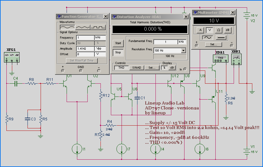

Everything tells me, that AD797 is not only a very good operational amplifier
The topology used has got to be something extremely good!
Using only the simplified schematic from Analog Devices datasheet
I get some extraordinary simulation results.
(And I am used to see a few good figures, from my own circuits. Using same transistors.)
A few details from me, for those who want to try to make a better AD797 Clone.
... but I am not sure anyone could do this better than myself
... maybe get some similar results, but not better, I doubt.
My circuit is in attachment and follows the AD797 schematic
- what I know from reading This Datasheet Very Closely
Lineup Audio Lab
AD797 Clone - version 2a
by lineup
... Supply +/- 15 Volt DC
... Test 10 Volt RMS into 2.2 kohm, = 14.14 Volt peak!!!
... Gain= x10, +20dB
... Frequency, -3dB at 600kHz
... THD <0.001%, my MultiSim does not show anything = 0.000%, see picture
Some more details:
All transistors BC550C and BC560C.
Total Supply Current 8.0 mA
Output stage, like the original biased only 0.5 mA ( 492uA more precise .... )
Good Luck Fellowes!
You may need really it 😀
Regards
lineup

In the sim you have perfectly matched current sources, perfectly matched transistors, of course your THD is close to zero.

As janneman hinted earlier, anyone can build a 'perfect' circuit in a simulator. There is a great deal of difference between the fantasy of perfect components and the reality of imperfect parts out in the real world. Even matched transistors do not approach the ideal units in a simulator.

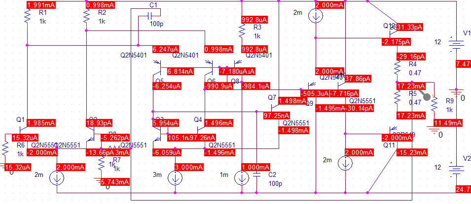

Q7 Base
should be at Q4 collector = The output to buffer.
There might be some other faults, too
... like C1 NOT to Emitter, but Collector of Q5. If I remember AD797 circuit.
Your picture is not 100%, so Try those changes first.
Then we see what happen.
You may also adjust R3 (1mA current).
Make it a TRIMMER, because it is important to adjust R3!
Remember will be 2mA across each R1, R2 !!!!!
So logical: R3 = 2 x R1.
Something like ~2 times. Adjust trimmer R3 for best balance!
