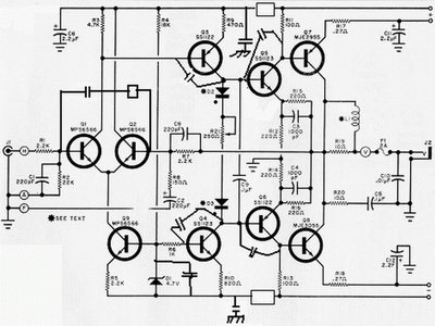

I found this project and it looks realy easy... no thinking required... I need one like that for a change.
Prolem is, 3 of the transistors are no longer freely available.
So, I would like the silicon gurus out there if there may be alternatives I could use to the following.
schematic : http://www.swtpc.com/mholley/PopularElectronics/Oct1971/PE_Oct_1971_Pg28.jpg
1. SS1122
2. SS1123
3. MPS6566
Thanking you in advance.

SS1122 = 2n5415, 2n5416
SS1123 = 2n3439, 2n3440
MPS6566 = bc182, bc546

Nordic...common transistors will work fine there
Q5-BD139C
Q6-BD140C
Q1,Q2,Q4 and Q9- BC546
Q3-BC556
I think they may work fine with those...also the output can be replaced by TIP3055 and TIP2955
I think that voltage amplifier and mirror will need a capacitor from colector to base (Miller)...33J
It is a good idea to include small capacitors into the drivers too..from base to coletor (10J)
From the first transistor base to the feedback one, a series of 100pf and 100 ohms will be nice.
Small capacitor (100N) in parallel with D1
The inclusion of rail resistors (2) of 47 to 100 ohms, and filters also, to input DC voltage.

The last paragraph does say it got hot under testing but not during regular listening, also the building instructions have some thermal management instructions.
Thanks Uncle Carlos, I found somme specs for the mps6566, it seems closer to 2n222 except being 10v as opsed to 5.

The original tigers were way ahead of there time. but had many problems. Audio Amature did a rebuild of these and talk about many of the problems. like the Bias resistor stack being underated, the use of inferior PECOR brand transistors etc.

I have the link for the Universal tiger from 0ct 1970 too, it is mentioned on the first page of the plastic tiger as being 80W (front page of article claims 125W), but I have not read it through yet...
The major diffirence between the two amps, is that the PT uses plastic transistors, and is therefor rated much more conservatively. I do like the mix of solid state and class AB as a "beginner"

My Father built a 20wpc version in 1973 and it always had bad crossover distortion at low volumes. I think raising the bias point would have cured that but i think he said he tried that and it never fully went away with his.

"Audio Amature did a rebuild of these and talk about many of the problems. like the Bias resistor stack being underated, the use of inferior PECOR brand transistors etc."
Your memory may need to be refreshed.
The Audio Amateur author had problems with the Tigersaurus oscillating BECAUSE he chose to substitute Pecor output devices for Motorola, and the amplifier subsequently blew up.
The voltage divider string for the slave outputs burned up after a period of time on ALL of those type of amplifiers, Dynaco, SAE, GAS, and SWTPC. The only one that I haven't seen burn up was the Heathkit AA1800 (designed by Leach), it had a predriver stage (more current gain), and did not need as much current in the voltage divider.
The first pair I built as a teenager were the 175 mono blocks. Through a wiring error I tried to let the smoke out, but didn't let enough out, as it worked (after I corrected the wiring error).
I always wondered about those people that couldn't get theirs to work. Could they possibly been more inept than me?
I even built a pair from blank boards, populated with ECG outputs no less, and they worked fine.
The first time I had a problem with one was with the newer 60W model with the full comp dual diff front end. It oscillated at 2Mhz after being completed, but only through the AC coupled input. It worked fine through the DC coupled input. The input coupling cap was a tantalum, and the cause of the problem. While the amp cycled the thermal cut-off all day (until I found the problem), it ran hard for several years afterwards driving a 4 ohm load.
SWTPC were not 'shake-the-box' kits (like Dynaco or Hafler), they gave you a bag of parts and a schematic, no fancy step-by-step manuals with photos and drawings (like Heathkit). I shouldn't be surprised so many had problems getting them working. It also helped to have some test equipment, and know how to use it.
The CFP output stage can work and sound fine when done right, I see lots of vintage Marantz and Harman Kardon on eBay all the time. I also see some that blow up (the HK 870 comes to mind).

The rebuild article in TAA was fun to read:
"I have repaired dozens of blown amps over the years, but never had I witnessed such a scene of cataclysmic destruction. The evidence confirmed the horror stories I had heard: the fiery reputation of Tigersaurus was apparently well earned."

Wow, I can't believe the stories about the tigersaurus.
I built 8 of them. 7 came up 100%, never a glitch.
The 8'th one, my friend connected the rails backwards..during powerup, two resistors glowed orange....turned it off, figgered it out, reconnected correctly, then powered up. (the kit had all one color wire)
Four went into service powering a nightclub (disco era, 1978-9). 6 nights a week, 6 hours a night. I never had to repair one over the course of two years or so..
Four I used mobile with 4 K horns.
Historically, only two issues.
R14 sets the front end current sources, it dissipates over spec, wrong part selected..it's a 10K 1/4 watt, it ran hot till it opened.
The zener sets also run hot, they should have better pad designs to draw the heat out the leads.
The 200 ohm dividers are waaaay too hot for the physcial design they used, so I converted to 3ru racks with major airflow channeled over the boards.
That also fixed the output sinks..the orig design was also too hot, I remember cooling the heatsinks with ice cubes during a gig to get the unit back on.
Oh, almost forgot..I turned the bias pot way down..audible notch under a watt, but made it thermally stable as all getout..
Cheers, John
ps..I did forget..back in 86, 87, 88 (memory is foggy), basement flooded...my twin tiger under 14 inches of water.
Dried it for 3 to 4 weeks, opened and cleaned, powered it with a variac..came to life, hasn't failed yet.
Cheers, John
