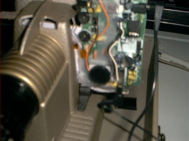

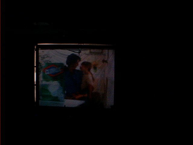

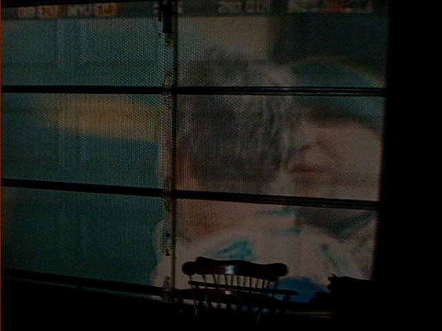

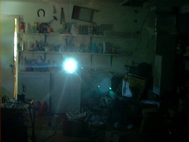

Okay, as a flow up to my post "My Projector Sucks" In which I tried to use a LOA to light a LCD, and by the title this method did not work very well. Anyways, today I paid a visit to a flee market and picked up a slide projector. the thing was that the only slide projector is quite old, and appears to use a outdated blub--It is a 300w Bell&Howell light, and has four filiments in the bulb-I don't think its halogen, and say 25 hours on it (So I will need to revaluate my lighting system. Anyway, figuring what the hell, I poped my LCD in there and WOW!, A clear, bright and large picture was presented in front of me!! It works for about 10minutes, before the LCD starts to get hot, and a black blob on the screen tells me to turn it off. I have some first pictures for you all.
The unit.
The unit.

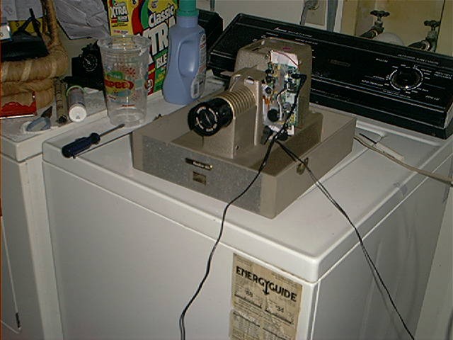

5. The projecter, aimed at garage door. Intresting observation--I spent over $50 on parts trying to get this projecter to work, all failed, but a $3 slide projector did the trick.
For now I have two issues to work out...
1. Heat, I can only run the unit for about 10 minutes before the heat effects the lcd, I think a peice of heat glass might help this problem.

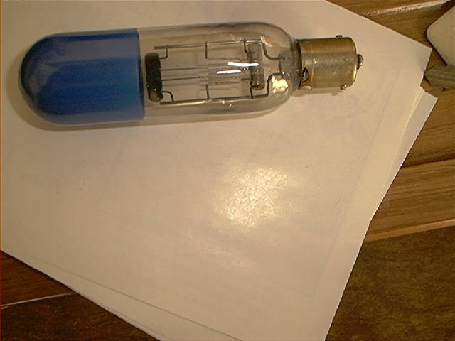

2. the light source, when the blubs cools down I will post a picture. it is atleast 40 or so years old, so I don't think I will be able to find a replacement when i dies. I need see if they still can be found, and for how much--or figure out another light source for the unit.
bell and howell bulbs
I reserve the right to say that it is not necessary to think negative about the replacement of 300 watt buulbs.
try keysan.com or photoimage.com
i think you will be surprised about what you can come up with.
See the bell and howel slide projectors have veen used in hi tech places and stock of bulbs come up in some pretty weird places.

the projector is a TDC Headliner 303 projector. It appears to be from the 1950s. The good thing is becuase this baby is before plastic, it has all glass optics, no fresnels here! there are several lens to focus the light onto the main lens. The Lcd panal is a 1.8inch lcd panel I look out of a casio EVO-200 portable tv. the panel is not very good, maybe 40,000 pixels. the screen is a little bigger then a slide, but only the very top right is cut off. the projector is made of metal, and after running, can burn you if you touch the top of it. There is a cooling fan that is quite nosy. right now I have to work on LCD cooling so I can get better run times. Also as stated above the issue with bulb life I will have to confrount.
you should build a box around it or disassemble it alltogether. i think a new light supply would be the best way to go. but for 3 bux you should be happy 🙂. me im going to buy an ARTOGRAPH i will be a guinea pig 😱 well... i hope it works
WHOA! i just found out that your projector has 7300 lumens!! if yuo change light supply your gonna be out of ALOT of light http://www.donsbulbs.com/cgi-bin/r/b.pl/cmv~cmt.html

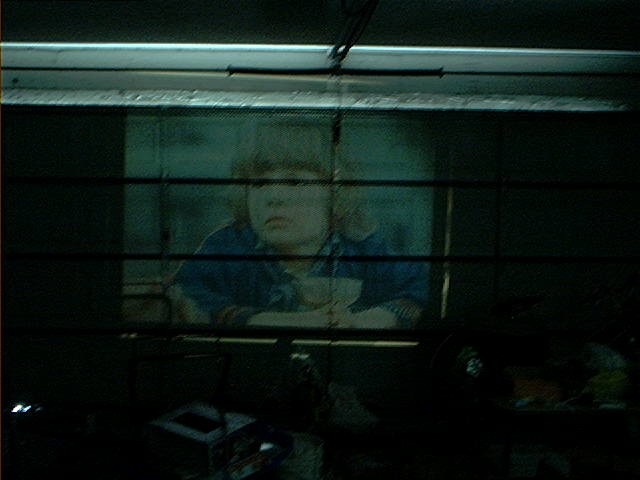

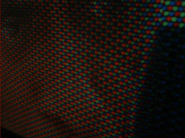

Update: I cleaned the lens and DAME this baby is bright!!!! I set up the screen and am watching the NY/GB game. The picture is VERY bright projected onto a bedsheet the images is about 7-8foot big, maybe close to 1,000 lumens of output! I wish I could make it even bigger, but this pj has a very long throw distence-over 20 feet for a 7-8 foot picture. I will keep you guys advised but this slide projecter rocks!!!! I just wish I had a better LCD panel, this picture is very pixalated, putting it out of focus helps, but text gets smeared. anyway this baby is keeping me happy tonight atleast!
Small heat glass
Hey if you're only using a small LCD panel, check out American Science and Surplus for some heat mirror glass.
Heat Filter
A little pricey for a 2” x 2” x 1/8” thick piece of glass, until you figure that this is pretty darned talented glass, and that it filters heat and reflects infrared and ultraviolet rays. Then it’s a bargain!
34410 HEAT FILTER $4.95 / EACH
Not sure if you'd need 1 or 2 to cover your space, as it's only a 2" square, but for $5 you can't beat it.
http://www.sciplus.com/category.cfm?subsection=21&category=191

Sorry to burst your bubble--but I gave up o n this approch. The resolution was just two low, the pixils on a 110" screen where about the size of golfballs. All things consitered, this project wetted my appitite for building a projector, but after the 'wow' factor wared off, the picture really was not watchable. I would go with the overhead/lcd panel approch if I were you--it would yeld a much better image.
