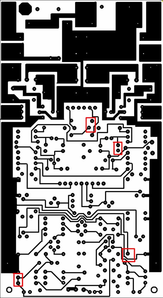

Okay, I think this is the circuit layout for the back of the board. The board is covered with a blue coating which makes identifying the tracks very difficult. I think I did them all right. However I need to tripple check.
Here is a picture of the backside of the board
Re: Slow and steady...
anatech said:
You've done some very good work there! Make some of the other traces wider, similar to the original board. Get another pair of eyes to check your work to be safe.
-Chris
Chris, if this guy can reverse eng that board and get a duplicate running, well, I'm going to retire! 😉 That is great work and very tedious compared to the Crown DC300A.
Send me a BIG jpeg and I'll have a look if you want a second opinion? Did you use photoshop? Nice to see this progressing.
Shawn.

I made the layout with a program called "Sprint-Layout 5.0," only it was a Demo that wouldn't allow me to save or print. So I took a screen shot, then used photoshop to make it black and white.
Here are the large pictures (Click "Download File" at the top of the page")
http://s29.quicksharing.com/v/1158894/1PCB.zip.html

I hope that helps. I printed the board image on glossy high rez and held it up into the light like an x-ray; the only areas that raise concern are included in the attached. You may find if you have a desk lamp, it is good to place the PCB very close to the light bulb and study the trails.
