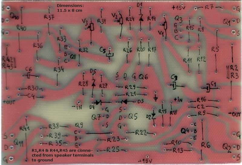

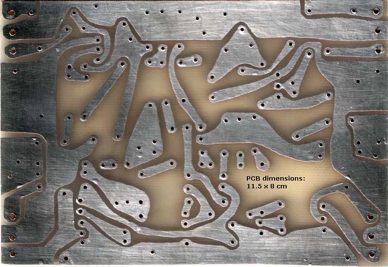

Here is the PCB I made - one sided, old DIY method - water-resistant marker, HCl (15-30%) + H2O2 (10-15%)
bottom view:

Hi guys,
it's an old DIY method (I used it for prototyping when I was more in electronics - back in '80s).
You prepare a drawing of PCB on the paper, scotch-tape it over the CLEANED and dried virgin board, drill the holes, use the waterresistant marker to draw the connections.
Then you mix the small quantities of chemicals (muriadic acid and hydrogen peroxyde) in plastic or glass container as Nixie said and dip the board in. After a few minutes (depends of concentration of chemicals) the copper will be eaten and the areas protected by marker will be untouched by acid. Now you clean the board with aceton, wash it, dry it, smear it with soldering cream, use the small amount of solder to cover the copper, clean it again and that's it.
Take care, there will be some heat and fumes in the procces.

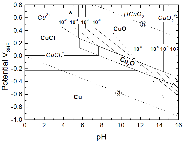

In order for the gibbs free energy of the above reaction to be negative, the dissolved oxygen concentration must be well above the saturation limit of oxygen in water. Further, the following reaction has a much more negative free energy than that of the above reaction, meaning that it will take place preferentially.
O. + 2H(+) + Cu --> H2O +Cu(2+).
I've attached the Pourbaix diagram for the Cu - H2O - Cl system for your reference. Note that CuCl4(2-) is not present as a stable specie. (Reference: D. Tromans & R. Sun, Journal of the Electrochemical Society, Vol. 138, pg. 3235 (1991)). Note that the area notated by the "*" in the diagram represents the area of stability for CuCl2-3Cu(OH)2.
Carpenter,
Yeah, the first of two graduate level electrochemical engineering courses I took during my masters degree consisted solely of deriving, from first principles, the full Butler-Volmer equation, including the extensions for mass transport and fluid dynamics (including turbulent mixing). That was one course I thought would never end.
Cheers, Terry
