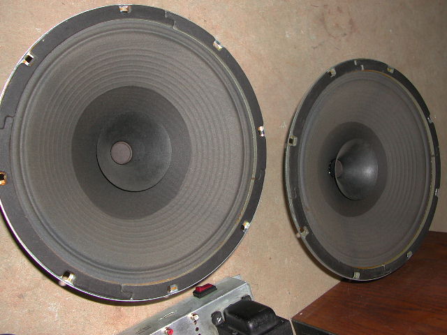

What are those? They look to have good possibilities.

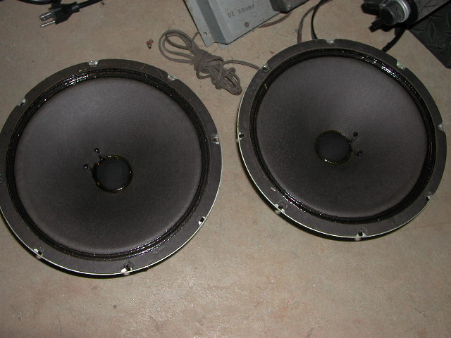

Thanks! They are early 12" dia., 60's RCA console drivers, accordian surrounds with whizzers. I have been working on the SE 6BQ5 amp that came with these, still having troubles getting the inputs right. I need help to finish it. In the meantime, I have these drivers to put to good use. Several folks have said that since they came from a console, an open baffle is a good project for them. Your thoughts and help is greatly appreciated.
They look great for their age. OB of some type is the way to go. They may also go well in a full size BR, probably not so well in a ducted one.
Start with an 8x4 ft (standard size in your land? as large as you can) sheet of good ply, cut it in half. Cut the holes above the centre line. ie keep the drivers away from the floor. Add a few cleats and pannels to make it rigid, and provide depth so it will stand upright. You can tilt it back if you wish.

Thanks Geoff! That's a 4' x 8' here as you stated, cut in half that will give me 2, 4' x 4' pieces (I knew that math would come in handy some day!). I'll try vertical side "wings" to keep it upright and a bit stiffer. I have a small pair of horn tweeters (cheap lil' things but they might do for now). How would these be wired in with the large drivers? Ihave no experience with crossovers or such connections. Capacitors in there somehow? Thanks again!

Smokehouse Bob, with whizzers those 12"'s are designed to have at least some treble. You should be able to hear cymbals well enough to enjoy the song.

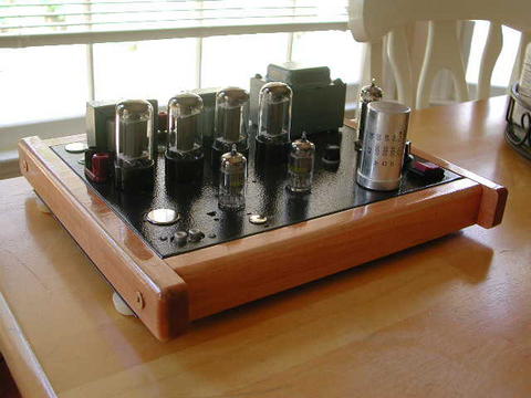

Bob, those look good. What is the 2nd, newer one? Octals? I only have a little experience with tubes and am currently looking for an integrated tube amp for some fullrange drivers I have - Fostex FE167e, FE108es, 8" Hempcone.

The second one is a Magnavox 6V6 PP, 1961-ish. Sound belongs to Magnavox, cosmetics are me just having fun! A nice amp, I have 3 or 4 like it. I have some bugs to work out on a couple of them. If successful, they may leave the stable. The first amp is an AA-50 Heathkit. Big ol' 7591s to heat the room! Here are the Fisher drivers.
