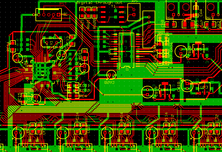

There are forums and threads for Class D, Cross Over, multi-amplifier, but I thought there are no thread for all combined issue.
I'd like to know anyone playing this way.
At recent, some chips handles digital input and amplification, also Filter for cross over / multi amplifier.
I know TI's TAS5508 and TAS5518, Apogee DDX. Common way of handling is,
(1) Supply I2S PCM signal to chip
(2) Micro Controller handles I2C registers for filter setting, volume control, muting, dB offset for each channels
Attached photo is Apogee DDXi-2161 8way board.
and here is TAS5518 4Way.
http://koon3876.blogspot.com/2006/11/tas5518-and-tas5121-8-channel.html

No one interested?🙁
(you love multi-amplifier) and (you love class-D)
then you will love TAS5518.
TAS5518 can contain cross-over in itself, and can control up to 4 way amplifiers. You only need some micro controller with I2C. PIC, AVR, 8051, MSP430, any can do it.
this piece of code
const unsigned char CH12_Q1[20] = {0x00,0x00,0x13,0x78
,0x00,0x00,0x26,0xEF
,0x00,0x00,0x13,0x78
,0x00,0xF4,0x66,0xEF
,0x0F,0x8B,0x4B,0x33};
I2CWrite(TAS5508_ADDRESS, 0x51,CH12_Q1,20);
I2CWrite(TAS5508_ADDRESS, 0x58,CH12_Q1,20);
will set 44.1kHz, 300Hz 24dB/Oct LPF to TAS5518's channel 1 and 2, so it can be woofer driver.

dwk123 said:As far as I can tell though, it lacks per-channel delay.
Yes! TAS5518 has no delay, BiQuad filter is a digital implementation of http://www.linkwitzlab.com/filters.htm .(Linkwitz Riley 24dB/Oct crossover). I loved this design and very natural sound when I made 12 opamp crossover. now it's inside of one chip!
for delay, phase issue, I'm keeping Xilinx XC3S500E FPGA board to build FIR filter future, but almost satisfied now.

Hi imam,BWRX said:
but what's the point if you're into 2 channel audio which (in my opinion) is really all you need for critical/pleasurable listening anyway?
Of course I'm a piece of DIYer and built many speaker network, huge DAC, crossovers and PGA2311 volume, class-A ,chip, or class-D amps etc etc, then now I found speaker have to be multi-way for my satisfaction but components should be as simple as possible, and analog areas should be as few as possible.
So, full digital & integrated Volume control/LPF/HPF is my current interests.
For Brian's board, to work it,
(1) DAI module (SPDIF In, I2S Out)
(2) TAS5518 (I2S In, PWM Out)(I2C In)
(3) MCU to TAS5518 (Config In, I2C Out, 8Bit out)
(4) Power Supply (8Bit in, 0 - 50 V/10A Out)
4 Functions are required.
(1) is very common issue, many DIY example.
(2) is not so difficult, I can give it.
(3) Difficult!
or, requirement is not defined yet.
Now I'm trying 2 way (powerful MCU+LCD+Key)/(PIC + DIP Switches), but still both merits and demerits. Huge software or Huge hardware, not a KISS(keep it simple and stupid).
(4) will be Linear power supply with parallel DAC input voltage.
It will have 30dB PSVC control, 1.5V to 50V.
There will be some DIY sample of Linear power supply..
I'm still thinking about optimized way of implementation.

TAS board, I don't have generic EAGLE or something CAD(I'm using expressPCB) so I'm not eligible for group buy?
and important.. I already have my tiny PSVC so I don't need huge power supply.
Hi Markus,
Now I have all conbined one. connection can be 8 inch length to TAS5121 and no problem on wave form. You can see not-a-beautiful CS8416 sample configuration on my board, or I think there are many examples for CS84xx at DAC forum?
If you download and install expressPCB, I can post actual file.

TAS5518 module
anyone have EAGLE can write
http://photos1.blogger.com/x/blogger2/6693/4591/1600/739394/TAS5518-04-Digital-5518.jpg ? then I can support.
Or.. Shall I purchase EAGLE?

TAS5518 module
Koon, please buy EAGLE 😉
