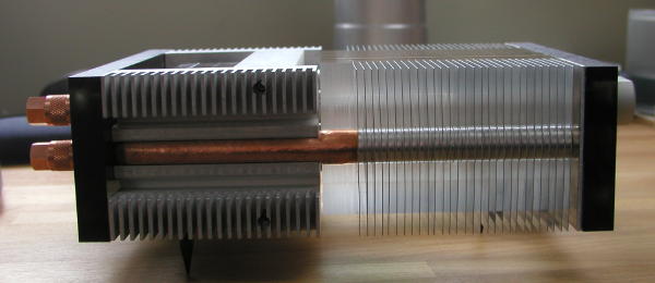

I probably went a little overboard with this one, but couldn't resist the temptation to use those cute heatsinks. So here's my next gainclone implementation.
I was concerned that those heatsinks might ring a bit, but overall appeal was much stronger than common sense and the whole creation is more of a modern sculpture than an amplifier.

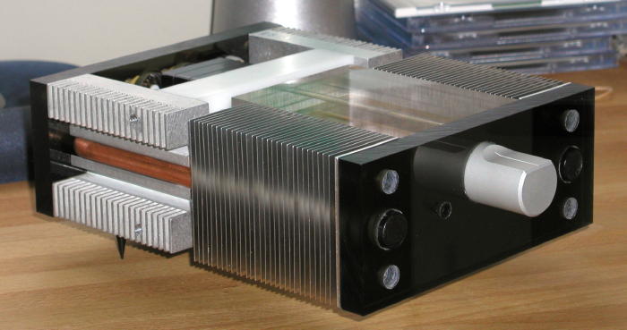

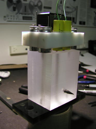

The big chunk of acrylic in a center is there to add mass to the structure as well as to damp vibrations created from the outside. The white phenolic block is used to mount PS caps (stripped BG) and Hovlands coupling caps.
The Black Beauty pot is at the back and the shaft tunnel 😉 had to be drilled through the acrylic. I like the see through effect, which adds lightness to the structure.
There will be no cover and this is an open concept amp.😉

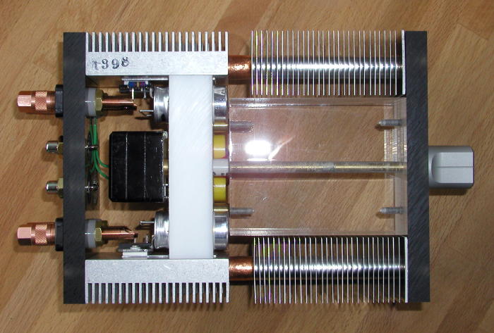

The structure rests on 3 spikes deliberately positioned under acrylic piece and under IC's. They release vibrational energy to the supporting shelf. You can see the effect when running a finger through the blades when holding the amp and comparing the effect when amp is standing.

I'm using 100k pot, 2u coupling cap, 10k series resistor and 220K feedback resistor. Positive input is directly shorted to ground.
This amp has no hum whatsoever and the bass is really deep. Smaller value cap makes it probably faster and 1000u BG seems perfect for this application. What I like about such capacitor bank is that it can be basically mounted on IC's pin and the signal path is very short. But it would be interesting to try larger values to see a difference.
I do everything by hand, no milling machine, so manufacturing chassiss parts is not very economical for me yet.😉
Acrylic is very friendly to machine though. The 2.5" block was easily cut on a table saw with Freud laminate blade and the cut is perfect, no chipping. The front and rear panels are rough cut, no sanding, and they look quite nicely this way. The acrylic block was further machined on a router to achieve the angles and uniform matte finish.
The hardest part was to drill the hole for a pot's shaft as the plastic stuck to the drill bit as it got hot, so I had to go slow, changing the size of a bit often.
This amp is very sensitive to proper placement, so a rigid chassiss is required.

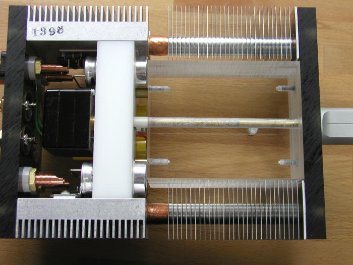

If you omit the resistor and parallel cap from positive input to ground (as to Thorsten schematic) the sound becomes somewhat cleaner. I'm also not using 0.22 ohm series resistor at the output, as well no 1u cap between rails (not enough space). So basically you need only 2 resistors to make implement this amp. I didn't play with different types (as it surely make a difference) and I'm using Rikken carbon film types. Probably with this amp they might be beneficial, adding a bit of warmth and body to slightly forward sonic signature of the chip.
The way I build my first one was to make everything compact as possible and reduce possible vibrations. Thats why the chip is directly mounted to 1/2" aluminum rear panel and PS caps have special mounting block to avoid resonances. The first one sounded very well, will see how this one performs. Have to finish wiring and PS first.
