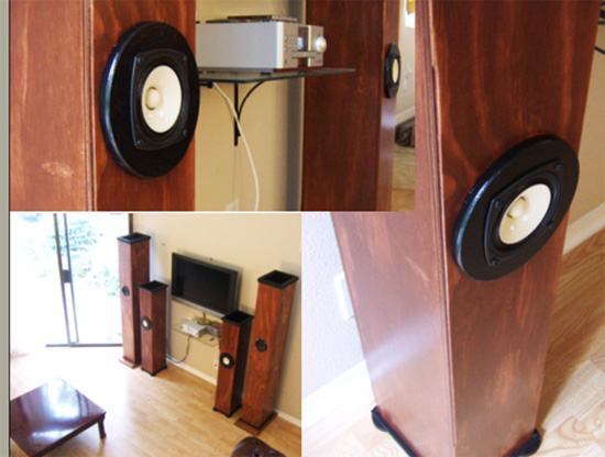

"El cheapo" BIB completed about one month ago, and wanted a smaller BIB for the upstairs and put in the FE107E.
You can read about the "el cheapo" BIB here:
http://www.diyaudio.com/forums/showthread.php?s=&threadid=89831&highlight=
I completed the "twin" with higher cost FE107E ($33/each), with the help of experts here. I had only circular saw and flabby muscle but for the twin I had to learn to use router, and had to give in and buy a circular jig and figured out how to use it properly. (still have 10 fingers). Circular speaker baffle, corner treatment, and feet are born. Cutting the molding with hand saw is a pain since takes long time to hide the mistakes...
My wife likes the smaller size better so the living room gets the smaller twin and the el cheapo goes to next to the piano in another room.
Oh?, sound?, both are very good to my non "golden ear". Maybe higer notes are better with the FE107E but purely subjective. My latest molding can be better, this is addicting... If u like more pictures look here.
http://gychang.smugmug.com/gallery/2055074
gychang

Nice!
How do the FE107's perform?
Re: Re: twin BIB born on thansgiving day
I like the looks of the FE107, clean white color, playing classical and jazz guitar music through them sounds fine and detailed. Compared my "el cheapo" speaker with similar loudness with same midfi equipment, perhaps FE107 seem more defined at higher frequency.
Both BIB sounds beyond "wonderful", the BIB cabinet indeed produces maximal base out of the fullrange I am convinced.
gychang

Both speakers look great gychang!
Which does your wife prefer? She seems to be enjoying your work. My wife stays away when I build speakers. My kids help tho!

gychang,
Congrats. How do they sound on upright bass or the lower registers of piano?

my wife prefers the smaller one, since the big one's are over powering, she says they sound the "same, both are good"... Smaller ones only have about 3 hours of playing time (may have to leave it on for several days...)

I notice BIB are great reproducing the bass. They don't seem to over power at all, to me very natural. Piano sounds realistic and right on. Am not sure what the deal is with speaker breaking in etc. My FE107E sounds good at only 2 hours of playing time as far as I can tell.

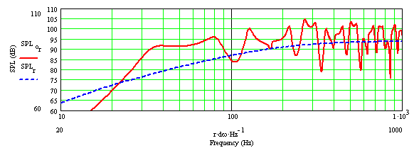

These things look tiny. What are the outer dims of the cab? Are they built to spec from Zilla's BiB page?
Kensai
Kensai
Kensai said:These things look tiny. What are the outer dims of the cab? Are they built to spec from Zilla's BiB page?
Kensai
the dimensions are from Zila's page, used 3/4" plywood. My other BIB is huge so make these pair smaller maybe...

I am ordering some of the Pioneer 4.5" to try. What was the line length of your BIBs?
I think I read 120" somewhere or, are 6' tall (144" line?).
Thanks.

I used the dimensions here for FE103E/107E
http://www.zillaspeak.com/bib-lowther.asp
gychang

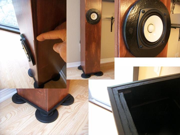

Re: nice build...
These BIBs are excellent for base extension.
I agree the cabinet details are very important, several points if I may suggest (based on my "extensive" experience on building 2 BIBs... hehe.)
1. best to have the side of plywood show up on the sides and not from the front (my wife hates the sides of plywood exposed from the front view).
2. inside of the cabinet should be pained flat black (otherwise it can be mistaken for a tall ashtray...)
3. on the top, molding of some sort improves the appearance in my opinion.
4. bottom should be imaginative... (not like mine, my daugter said "looks like micky mouse").

It is important to get the dimensions right for the particular speaker (another thread on BIB with NO base!! due to wrong size). If u can get Scottmoose to help u for the particular speaker u will be using (he will need speaker specs - not sure which parameters). He is a valuable source of information and very helpful.

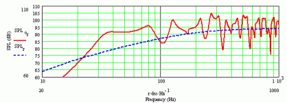

yeah, I am going to be doing a build soon of the 168EZ BIB, pimped out.
It will stand the recommended feet tall, but I think I will set off the internal baffle from the baffle a half inch or so and make adjustments to the height of the driver accordingly. This will keep those "point" resonances down, which might even be only imaginary in the end.
since I will be building it from 5x5s of 18mm birch, to get the horn the right length I WILL have to use "moulding," but nessie (f-2000) style with panels of scrap birch.
solid walnut suprabaffles and bases, lauan trim, brass rings, gold chains, dolla dolla bill y'all!

BTW Clark: FE168ESigma cabinet can be longer than I suggested on Zillaspeak. Like many people my ideas change & develop over time. The 168ESig cabinet was one of the first I came up with, so I deliberately went easy with it. If I were building one now, I'd preserve the existing pipe CSA and boost length to 140in
Regards
Scott
