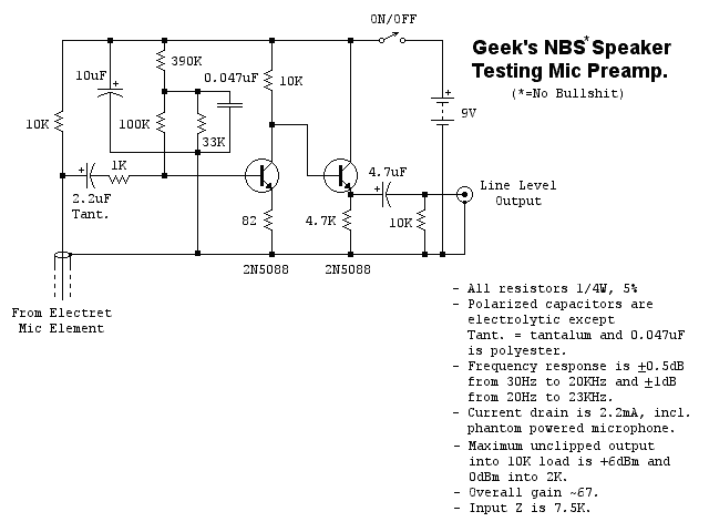

Bear with me, if you would. Circuits were never my thing.
There are two terminals to the mic cartridge. I can see where to connect the active output, but where do I connect the other one?
The 9V battery powers the mic as well?
EDIT: After looking more carefully, it seems like the ground/shield of the coax cable is soldered to the branch that goes off to the right, while the center conductor goes up.
OK, so wikipedia tells me that electret cartridges usually come with built-in preamps, so does your circuit just provide the power for it?
Hi 454,
Yup, electret's are two, sometimes three terminal. This circuit works with the two terminal ones and supplies a "phantom" power to it.
I've tried it with a couple of carts, an el-cheapo and an unobtanium one with similar performance to expensive testing mics. The circuit doesn't seem too picky...
Yup, provides power and some gain and line buffering. I've tried it on three boxes, a Mac, Win and Linux and related speaker measuring software and it functions nicely on all three.
I have not had a chance to calibrate the microphone, but it seemed well enough when tested against a reference fullrange that had a calibrated sweep done of it.
Cheers!
454Casull said:OK, so wikipedia tells me that electret cartridges usually come with built-in preamps, so does your circuit just provide the power for it?
