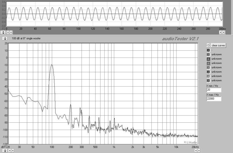

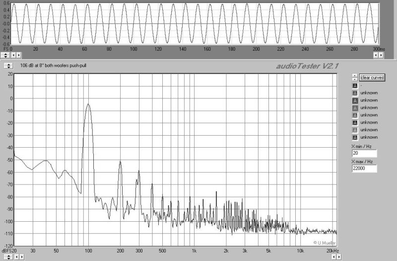

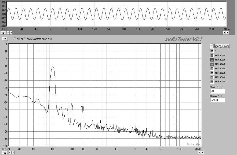

I have done some measurements on my open baffle woofers recently (shallow U-frame, 7.5" deep, 24" wide). The results are surprising.
- In push pull at 100 Hz both 2nd and 3rd are elevated compared to same SPL of a single woofer measured in front (all at 8" distance to mic).
- If I raise the dual woofer SPL by 6 dB to get the same excursion that a single woofer would experience, the case worsens even more.
Unless something was clipping I have no ready explanation for this. Pictures below. "woofer-s" is a single woofer, "woofers" are both in push pull. The woofers are Vifa 10" with decent Xmax, according to calculations far from excursion limits at this SPL (100 dB at 8" doesn't translate to much at 1m reference distance).
When in push pull the woofers were wired in series - this is where I suspect the issue (inductance? back emf?).
