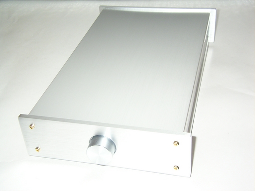

I've pretty much decided how mine is goint to look. Once Panomaniac has worked out the best mods for us....I'll remove it from it original case, use an Alps pot, some Obligatto input caps and one of the SMPS I showed earlier. Then I'll put it all into one of these nice enclosures which is big enouh to hold everything including some big PS caps:

panomaniac said:
Nice case! Looks like it's built by the same guys who make my Octopus Amps cases.
Can you provide a link to some info on the Octopus Amps?
I'd really like to have a look........
EDIT
OK- I found it here.
Octopus Amps
Very nice - and that case I'm looking at is quite similar indeed - but I think it is a bit bigger than yours (18cm x 30cm).
