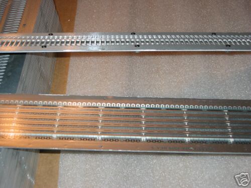

mid-tweets
Might want to track down a pair of these.. w/ xover @200Hz 24dB
http://www.atcsd.com/pdf/Product-Sheet-NeoPlanar-150.pdf

mid/tweet
Yes I've used them... thought you might want to consider them since they come up on ebay from time to time for ~400 / pair... and they are FAR Quicker than dynamics... especially in a dipole... ribbon like 150WRMS power handling... that sort of thing
thought you might want to do a little research...
The ones I got were custom fabbed, claim 92 ish sensitivity, response from ~200 Hz to 40KHz...
All I can say is they made quite an improvement to my RD75 dipoles..
http://www.diyaudio.com/forums/showthread.php?s=&postid=1055085#post1055085
ymmv
