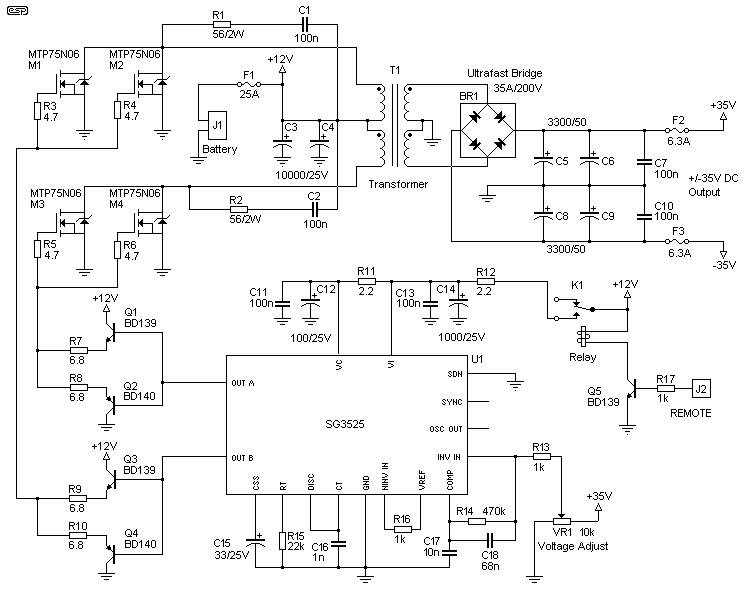

Hi laugo,
This one might solve your problem. SMPS won't cause any noises if properly designed. Afterall, there is noise everywhere..

rejithcv said:
Oh Damn it! I picked up the wrong file. Forget tat. Here it is ....
Awesome! Could this same circuit used for another output voltages, for example +-13 or +-15? Or must I change some components? This is perfect for the preamp, I ask for an AD coverter.

Hi lago,
Unforunately the pcb layout is not available. This design is actually for driving power amplifier at about 500w or more. In the case of preamp alone,I think you really dont need to choose this circuit. You can try a flyback topology. The o/p voltage can be changed to what u like.
