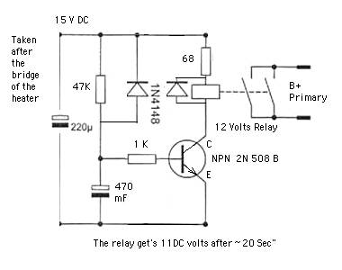

How about a custom made with a simple transistor a R/C and a relay
The power supply is taken from the heater circuit....
and the relay is used to switch-on the secondary of the B+
Take a look at the picture, sorry I didn't have the right values....
PS: I've done this in my SE 6C33C-B and works perfectly
for delaying the B+ Driver stage of 20 seconds and the
B+ of the final of 120 seconds...
Regards.
Alain.

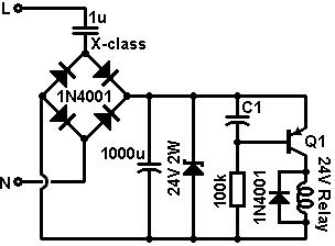

Here's another delay circuit which runs of the mains rather than the heater. Delay time is set by C1 ad is approximately 0.5 seconds per 100uF. The zener should have the same voltage as the relay coil. Obviously it is not 'intellegent' in that it only activates when the power is first applied, it doesn't detect faults or owt like that. Just thought I'd add it to this thread's collection! 😛
