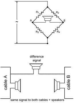

“Nothing paranormal” Can’t argue with that! But I think they missed the point. I claim to demonstrate the audible differences, not just electrical. And any test or audio signal can be used, even Elvis or ABBA.
The point is to conduct a rigorous test between what should be identical cables, same gauge and same length, with good connections, to find if there is a difference. Cables of different lengths and/or gauges could also be tested.
The test hinges on the difference. If there is one, then a signal will appear between the 2 sides of the balanced bridge. No difference, no signal. Pure and simple. Either there is, or there is not. Using a speaker or headphones across the bridge will allow the difference to be heard, if it exists. The difference could also be measured with voltmeter, oscilloscope, spectrum analyzer, etc. This is the Wheatstone Bridge, a circuit that has been used in measurements since the 1830’s.
Remember, -- all that is measured here is the difference, nothing else. That makes the difference very obvious, if it exists, because the difference is the only thing you will hear or measure.
Cables of different DCR will produce a difference signal in this test, but that can (or should) be ruled out.
If a difference is found, it will not tell you which cable is better. But by extension the test should be able to determine which cable is best, or at least which is of the “highest fidelity.” (More on that later)
There are, of course, difficulties in setting up the test and getting the bridge balanced using real loads, but those can be addressed. If the bridge is out of balance, you’ll know right away, that’s the beauty of the test. =)
I’ll go into more detail in the next post. Thanks for reading all the way down.

Can't argue with that. But I'm not claiming paranormal properties for cables. And I don't know any cable seller who is. They may be claiming absurd things for their cables, but the claims are almost always based on science. Bad science, ridiculously bad science sometimes. But science and physics. No cables I've seen claim to be better because of witchcraft, voodoo, the Virgin Mary or space aliens. They claim to be better because of some physical properties of the cable.
So let's forget the paranormal stuff, OK?. That's why my claim was rejectedb y JREF, but it has nothing to do with the validity of balanced bridge test.
No-one disputes that differences may be measurable with the right test setup (after all, they're just R, L, and C),
Ah, but some do dispute this. At least within "normal" boundaries. I agree that if the R, L and C are vastly different, there will be a noticeable difference in the sound. But many seem to claim that subtle differences in those values will NOT affect the sound.
Lets call them the "Zip Cord Club" (of which I my be a member). "14 gauge Zip Cord is all you need! Anything more is a waste of money! You won't hear a difference." OK, lets see if that is true. Let's test it. The balanced bridge is a good test.
On the one hand there are the cable enthusiasts who claim their cables are better because of better materials - pure copper, special insulation, long crystals, silver wire, etc. Or better because of special construction. Braids, ribbons, helium cores, cotton fibers, etc. And any mix of the above. The cable enthusiasts claim their cables sound better because of what these special qualities do - or don't do. If they are "better", then they are different.
An the other hand the Zip Cord Club claims that all that is nonsense, as long as the cable is of adequate gauge and is not causing amplifier oscillation, no one can hear the difference. Therefore NO difference in the audio domain.
But what if we test two different cables and do find a difference? Why is there a difference? Is it due to the different L, C, R values of the cables? We can test this. Simply add a few passive components to cable A, so that it matches the L C R of cable B. Test again. No difference? It must be the L C R values of the cable that give it its sound. No need to buy expensive cables if we can imitate the sound with a few passive components.
What if there is still a difference when the two cables have identical L C R values? Then we have to look further for what the difference might be.
The test is not limited to different cables. The same cables can be measured when they are deployed differently. For example, one cable run on the floor, the other on blocks. Is there a difference? You'll know for sure. Either there is or there isn't.
The strength of the balanced bridge test is that it removes the doubt as to whether a difference really exists. If you hear something in the bridge speaker, there is a difference. If you hear nothing, no difference. Simple as that.

Hi Panomaniac,panomaniac said:The demonstration will be conducted with real speakers, real amplifiers and a real musical signal, between non identical speaker wires. To be considered successful the demonstration will have to show an easily audible difference produced by the test speaker. The demonstration will be said to fail if no audible difference is found, or if the difference is one of simple attenuation that can be corrected with a volume control. The demonstration will also be considered to fail if the majority of the people listening determine that the audible difference is too small to matter.
You've only covered half of the conundrum. For the test to be valid, you also have to have comparisons between identical cables (ie the cable that the person is comparing is actually the same cable), giving the listener(s) the opportunity to "hear a difference" where there is no difference.
There are differences, Nelson Pass demonstrated this in 1980.
Good points guys, but you've got to start thinking outside the ABX. Stop trying to fool the listener into hearing something that isn't there.
Part of the test setup will certainly have to be testing two identical cables in the balanced bridge to show that no difference can be heard, that the bridge is truly balanced. Only then can the test proceed to different cables.
Of course this doesn't eliminate the idiot who "thinks" he hears something when there is nothing. And I should know, I've been that idiot. We've all wanted to do well on a test, right? But if it can be shown on the O'scope, voltmeter, spectrum analyzer, etc., that there is no voltage difference, then the claim of hearing something can be debunked. If there isn't any current flow thru the bridge speaker, there won't be any sound. Simple.
And the test should be done with a number of people present. If the majority claim to hear nothing, then there is probably nothing there. And that can be confirmed with measurements.
In fact, the hearing part of the test is icing on the cake. It is only there to let you hear the difference that can be more easily measured. And there may be ultra or infrasonic differences measured, but if you can't hear them, why worry?
and the point that a lot here do not seem to get - you will only hear a signal in this setup when the different parameters of the cables will "create" a difference signal that is perceivable.
If no difference signal is audible - even when the measurement shows some signal present - than it clearly shows that those signals are below the threshold of audibility.
And if they are below the threshold of audibility - they are unimportant and any claim as to audibility of cables can be thrown into the trashbin of unsubstantiated claims.
