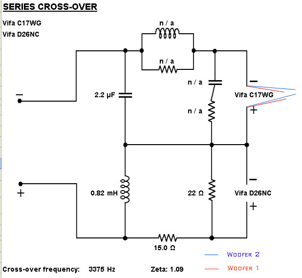

i've designed my prelim x-overs for my surrounds front and rear for my ht project.
But wondering what do i change in my design to change from one woofer+tweeter to Woofer+Tweeter+Woofer configuration.
i've used Andy Graddon's Series x-o spreadsheet to get so far with some help from him, here's my diagram for the surrounds:
.::C17's are 6.5" Woofers, D26 are 1" tweeters::.

can i just add another woofer off the same terminals for the first? i guess i need to change some components? some help please guys,

Crossovers work off impedances. The impedance of the crossover, at certain frequencies, directs some frequencies to the woofer and the other frequencies to the tweeter, respectively.
For it to work properly, the impedances of the woofer, tweeter and crossover must work together.
When you take your Vifa 8 ohm woofer and connect a second Vifa 8 ohm woofer in parallel with it, you have made your woofer a 4 ohm unit. Therefore, the crossover will not work the same as it did for the 8 ohm woofer.
If you want to hook the second Vifa crossover in parallel, or even in series, with the first, you have to redesign the crossover for a 4 ohm woofer or a 16 ohm woofer.
If you use a spreadsheet, Re and Le should be divided in half if the second woofer is hooked up in parallel. Re and Le should be doubled if you hook them up in series.

Well, I am not an expert on series crossovers, but if it worked for the single Vifa C17, a few changes of components will work for the two.
If you are hooking them up in series, then indeed it is 16 ohms.
I don't know that particular spreadsheet, but if it has a space for Le, (speaker inductance), generally given in mH, then double that too. And if it for some reason has a space for Sd (area of the cone), then double that as well.
Otherwise there is no reason not to simply change the components, unless your spreadsheet has a space for center-to-center spacing. I don't think too many do.

basically, if you run the C17's in parallel as shown, you will halve the coil value needed, you may need to adjust the resistor padding on the tweeter a bit. (I would avoid running them in series unless your amp has real problems with a 4 ohm load)
On the spreadsheet, enter the woofer resistance as 4 ohms, and up the sensitivity by 2 or 3 dB.
this i don't get? so do i only need a 0.44mh not a 0.82mh coil if wired as above in diagram.
if i give the driver an extra 2 db it makes it 91 for the tweeter and 91 for the woofers, and put 4ohms as impendance (did you mean 4x2? so eight?) spreadsheet tells me i only need two components, a 0.22mh coil and a 5.4uf cap which dosn't seem right at all.

I have used series with just 2 components, but generally only when the sensitivity of the tweeter is listed as 2-3 dB less than the woofer(s). the .22mH/5.4uF combo sounds pretty close.
So keep a couple of resistors handy for trimming the tweeter to the level you require. A small value in series or a light L-pad may still be needed.
