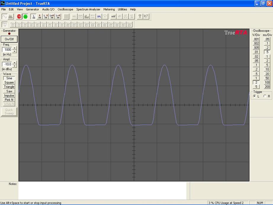

I tried it between a CD player and soundcard and could quite clearly see that the negative cycles were being clipped. The distortion lessens when I reduce the volume on the CD player.

The thing that bugs me most is Why does it only clip on the negative cycles?

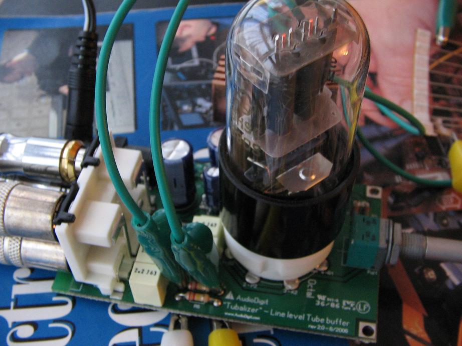

I don't have a schematic but may be able to make my own if it would be helpful. It would be good practise with this double sided board.
The pot at the front is supposed to be "Tube operating point"
Out of view at the back is a 6 Volt reg and heatsink.
The green croc-clips were there to try parallel resistor across the originals. This was advised by the seller. Lowering this resistance does help but lowering too much makes the sound very anaemic.
It looks as though the thing is behaving like an "infinite impedance detector", i.e. half-wave rectifying. I'm amazed that a 6SL7 can operate at all with only 12v B+. I'd love to know what the "operating point adjustment" is supposed to do!

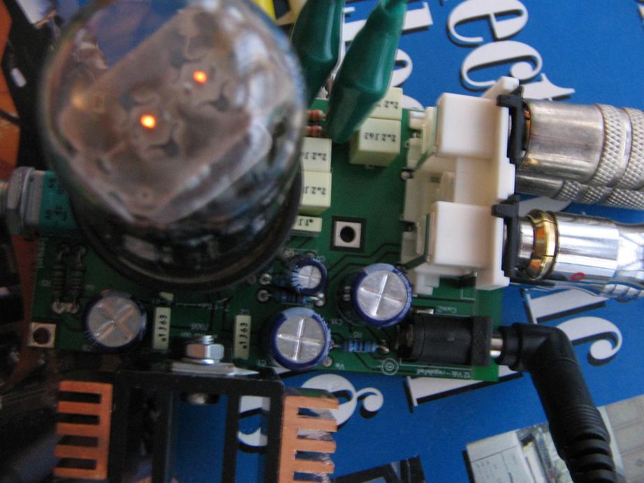

I may be completely wrong here, but I doubt if you'll get it working without increasing B+ to about 40v (and preferably at least 70v). This use of a 6SL7 is beyond my experience. There may be some trick the supplier is using. Seeing the schematic would answer important questions.
