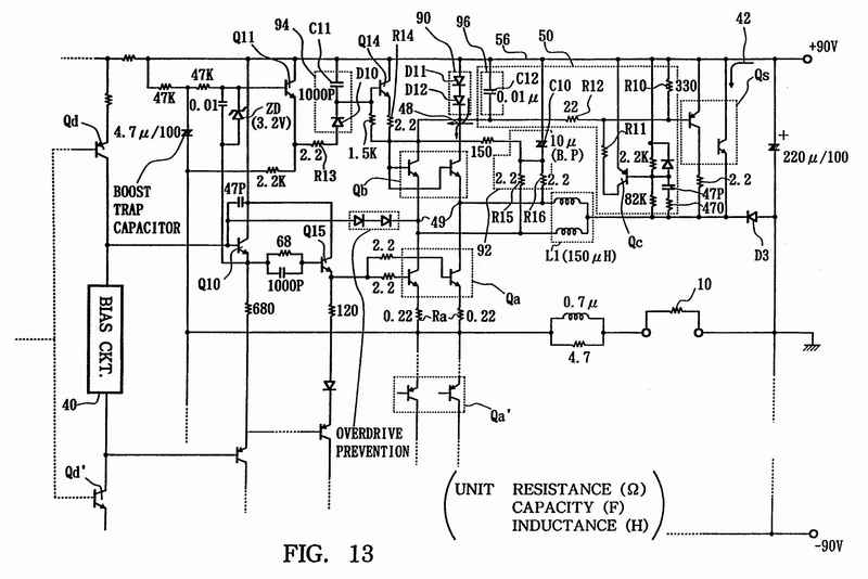

I think this one is the patent of EEEngine. Patent #5,347,230.
It's interesting, because classD principal is used for efficiency of rails, while the main amp still can be classAB or even classA.
The important component is in L1. The right side of L1 (150uH) is classD/square full voltage, and at the left side of L1 it is a voltage follower, following Qb to feed the output transistors Qa. Output transistors Qa is cascoded by Qb emitor voltage at low voltage, so the dissipation in Qa is small (compared to rail that is +/-90V)
If Qb's emitors are sitting at +5V, the from +5V to +90 (85V) is given by L1 from classD mechanism, efficient.
But is this schematic selfoscilating at constant frequency like UCD or not? Is this good or not?

EEEngine has been in the market long enough. The patent is from 1994.
Example of current product : Yamaha PC9501 : 3000W in 8ohm bridged. And it is classAB that making 3000W with 1rack size.

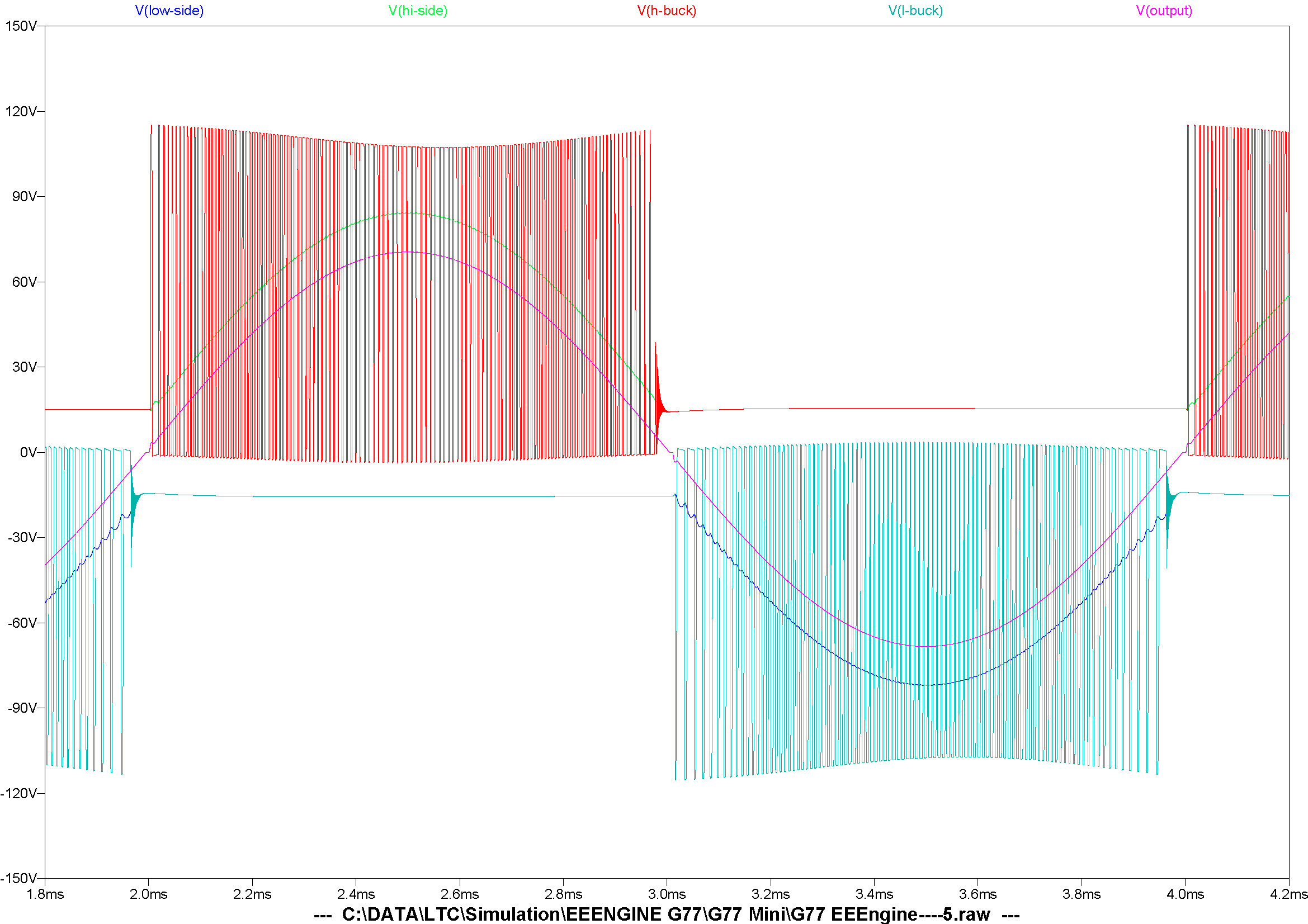

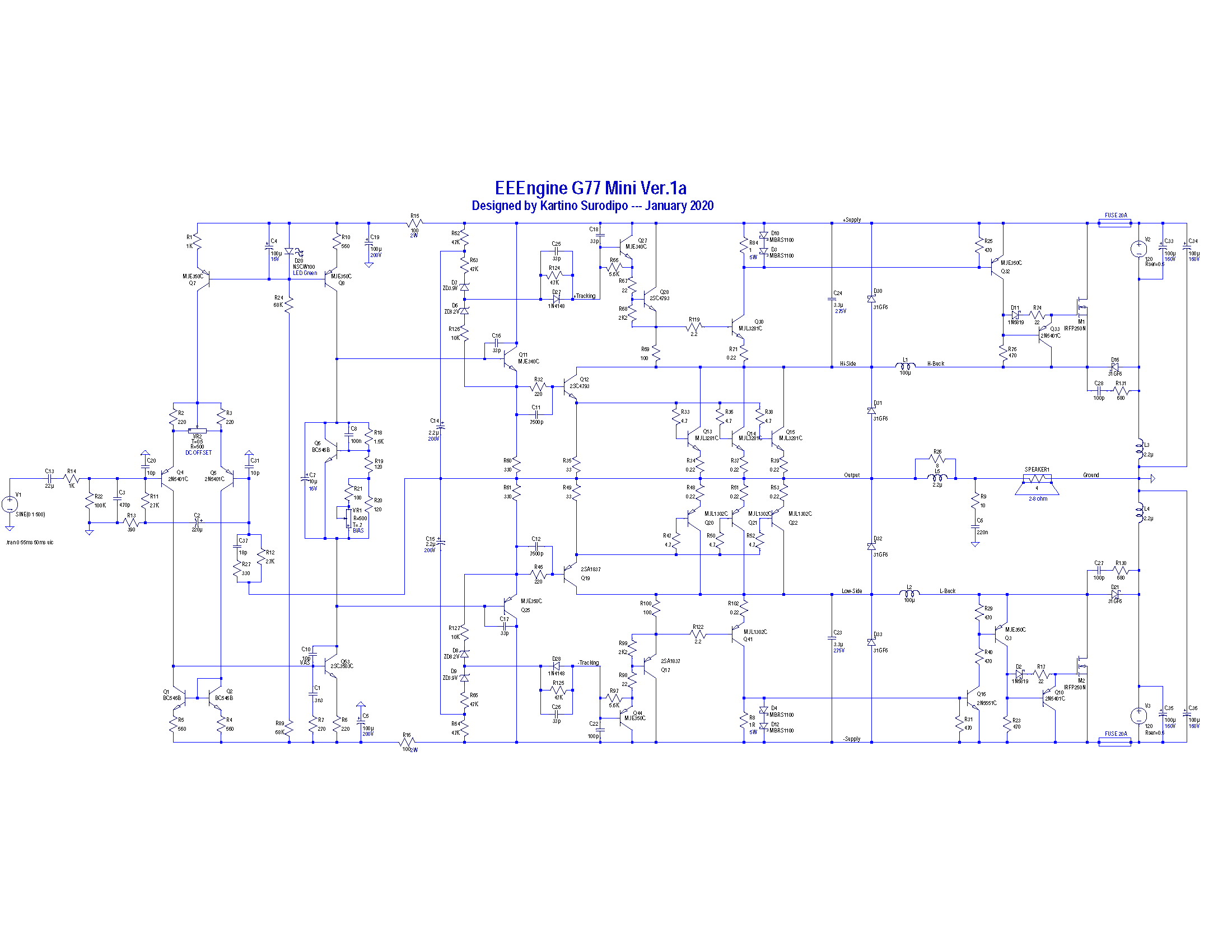

This latest EEEngine G77. This is actually simplified version of Yamaha P7000s, taken very basic needs, without degrading its performance.

can i use 3pairs bjt instead of 6 pairs?

Class AB from G77 EEEngine High Voltage Design by Mr. Kartino Surodipo
Tracking from Labgrouppen A50TD
nice job Roby , post the pcb files
