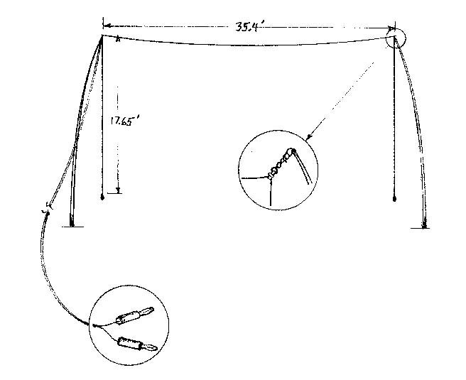

I ran a Yahoo search on 'half square antenna' (what a radical idea!) and came up with:
http://www.qsl.net/ka1ddb/20meterhalfsquaredwg.jpg
http://www.cebik.com/hs.html
http://kc5jk.tripod.com//sitebuilde...half-sq-ant.gif
"To get DX angle radiation and gain without the tower and the Yagi, use a HalfSquare. What's a HalfSquare? A HalfSquare is a simple, light, unobtrusive and inexpensive DX gain antenna that you can hang almost anywhere you can put a dipole.
How is it made? Start with a wavelength of wire supported from its ends, and feed it at a point one quarter wavelength from an end. In this form the antenna is called a long wire. It has a decibel or so of gain off its ends and its radiation angle is a little lower than a dipole or Yagi at the same height, but it's no killer DX antenna yet.
Move the support insulators in a quarter wave from each end and let the tails hang down. Bingo! What you have now is a HalfSquare-two quarter wave verticals separated by a half wave horizontal phasing section. By this simple trick you have pushed the takeoff angle down into the serious DX range and you suddenly have nearly an S-unit of broadside gain to boot. As a bonus the feed-point impedance drops to 50 +."
Notice the author mentions that the performance really increases when you have the exits 1/2W apart?
As noted in the Bose patent virtually any spacing from 1/8W (boom box) to 1W (straight cannon) will work, it will just require more equalization to smooth out, and be less efficent.
Assuming a loss-less tube: "providing a nominal 6 db increase in sensitivity compared to the same driver in the infinite baffle. "

I see a pipe about four feet long (lets ignor the small flair for this discussion) which will act as a resonant pipe with multiple predetermined resonant modes. That pipe is coupled at its centre point to a resonant cavity at which point there is also a driver positioned to excite (input energy) the system. Once the speaker does its job of playing some low notes (remember that the driver xmax and size are not major factors according to the patent) we are then depending upon the cabinet to amplify the notes introduced by the driver. The only way I see that happening is through a series of compound resonances which are built into the design of the cabinet (ie. the pipe and the cavity). The pipe if designed properly will have a series of broadly positioned modes available which is desirable. The large cavity will have a resonance (here I am not sure if there will be more than one [mass volume of intrapped air] {box dimensions may also come into play, width height and depth} which will be of a higher Q than those in the pipe due to the cavity volume. The pipe resonances will achieve a certqin amount of gain and this is then boosted or added to the gain provided by the cavity resonance. I will further guess that the cavity (due to its physical dimensions) probably has a fairly wide band resonance centred upon those of the pipe. The sum of both these two resonant systems provides the total gain to the notes played by the driver.
I cannot see any other means of gaining efficiency. If this is not how you view the system to work then I would be interested in knowing just how you do think it works.
I asked Dennis if he would provide some input regarding the Half Square antenna theory as he makes his living in RF design I believe.
Your theories on the principles of operation are very close to mine, with only a couple of differences. But the differences are quite substantial. I already have my theories typed out, as I know a guy that is also interested and I wrote it out to try to explain it as effectively as possible, as I understand it. I don't have any wild new radical ideas, everything I say is backed up by the patent info, but I find the patent is not well written and it took me weeks of studying the text and pictures to put it all together.
