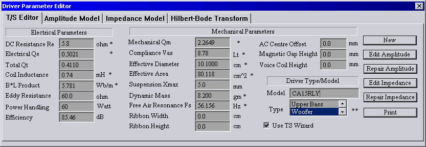

Hello again Omni (you helped me before), what a coincidence re similar projects.
I didn't realise that tweeters need Zobel too, if the impedance is fairly flat within
5 ohms? I'm not aware that many manufacturers specify Le for tweeters, needs
to be measured, I guess.
Thanks for Rod Elliot link - the 'preferred method', I will read, also many thanks
for the CA15RLY/27TDFC Zobel values - great stuff!
The only reliable source I have for driver(T/S) values/reviews is (for the CA15RLY)
Mr John Krutke's "5"mid review" and for the 27TDFC the "Tweeter Mishmash'
section of his site. Otherwise, only manufacturers specs which I realise in some
cases could be very dubious. So, the best I could do 'on my own' would be
'ballpark values', unless people familiar with the driver(s) kindly offer to help.
BTW, I 'discovered' these drivers in that site.
As Zaph pointed out regarding the Vifa P17's and D25's, there may be significant
'batch inconsistencies', so much so, that he cautioned about using them. This is
why I probably will upgrade to the 27TDFC's eventually (like the CA15's good
consistency, smoothish response and value). I would have considered Dayton but
they are not available in AU.
Your 2nd order network is undoubtedly a good idea, but my P25 10" and new Seas
mid seem to have enough overlap to allow 1st order for the mid bandpass and LP on
woofer. ( Tinitus seems to think it might work). I'm also assuming the rolloff slopes
allow this, it seems OK from graphs.

CA15RLY published specs VS Zaph test - a comparison.
Too be fair, maybe the Zaph units were not 'broken in'?
Seas specs: Eff=87.5dB, DCR=5.6ohm, Le=0.82mH, Fs=44Hz!, Vas=14Litre, Qts=0.34
Zaph test : Eff=85.46dB, DCR=5.8ohm, Le=0.74mH, Fs=56.156Hz, Vas=8.78Litre, Qts=0.411
maybe you err on an independent reviewers side?
All graphics from www.zaphaudio.com , thanks!
