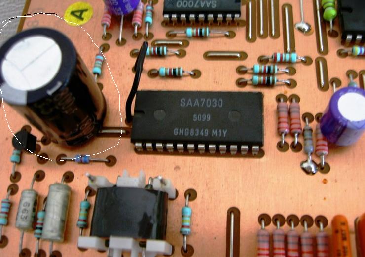

Here's something else to try- the picture below shows a portion of the decoder board from a CD204. The large capacitor that is circled has a stock value of 22uf. I replaced mine with a 1000uf low esr type (what I had on hand), though I'm sure the larger value shown in the photo wouldn't hurt. This capacitor is for the power supply to the crystal, and gives a big improvement in the overall sound quality of the player- I'd say as much as changing the op-amps.

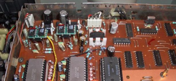

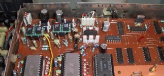

This also shows one of the other mods I forgot to mention:
The rubber band around the x-tal, and the 'wire wrap' ic sockets, to get the clearance for the browndog..
