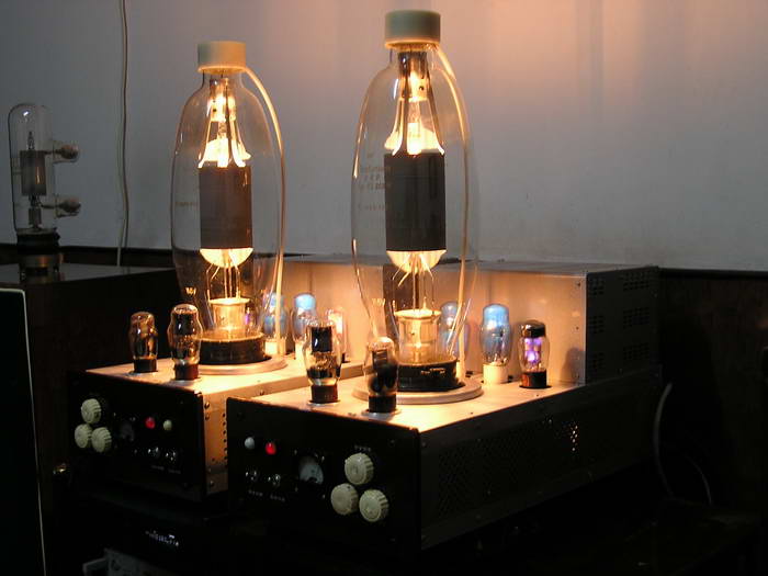

RS253 giant SE monoblock (Chinese)

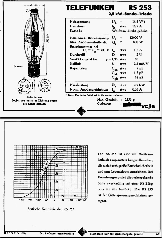

280 Watts of heater power
12,000 Volts max and 800 W Anode dissipation max.
mu of 50 and gm of 2.5 mA (hey - its grandpa 12AT7)
Run it really conservatively and you'll get 160 Watts Single Ended. Its probably run even more conservatively than that since 160W SE Output Tranny would be as large as the tube.
I wonder what would prompt someone to build something like this - surely it could'nt just be a case of my single end is larger than your single end - could it??

Braggin' rights. Fire that up and get a 200W SET. However, who really needs 200W? If you did, then a push/pull with pentodes would make far more sense. After all, getting an OPT that can handle the power, the DC magnetization, and work well at the low and high end is impossible. Once you pass the 40W level or so, winding a good SE xfmr becomes quite difficult.
