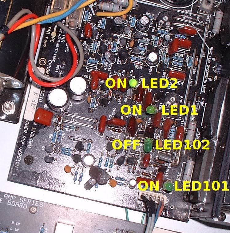

I was recently given a Cambridge Audio a3i, as it doesn't work and I thought I could have a go at fixing it instead of binning it... 🙂
Now, I have plugged it up and it won't output anything thru the speakers, no matter which input I use.
I have had it apart, and I've found what maybe the problem, one of the LED's does not light up at all:
If I leave it for a while, LED102 sometimes lights up for less than 1 second, which means the LED itself is ok, but something somewhere isn't.
All of the rest of the LED's light up, and go out slowly when the amp is turned off... I have yet to check the fuses with a multimeter, but they look ok physically (no burnt out wire visible)
I have also yet to check the rails, but I'm guessing they should be +50v and -50v right? Anything else I can do to try and find the fault here?

Looks like the power amp section is having a problem.Check the semiconductors first.The LEDs should be related to constant current for various stages or maybe bias system too.
Yep, it definately looks like the power amp is the problem part, there is an led for the pre-amp part, which lights up fine, but isn't in the pic I posted. Now how would I go about checking the semiconductors? There are four huge ones that are screwed to a heatsink, are these the semiconductors I should check? Also, how would I check them? I only have a DMM and access to a scope if needed, but I don't want to break it any more by putting probes in the wrong place.

The LED's are most likely references for current sources. They should all be well lit, if they're not then the amp isn't going to function. Hopefully, the output devices will be fine. If they aren't, it might not be worth repairing.

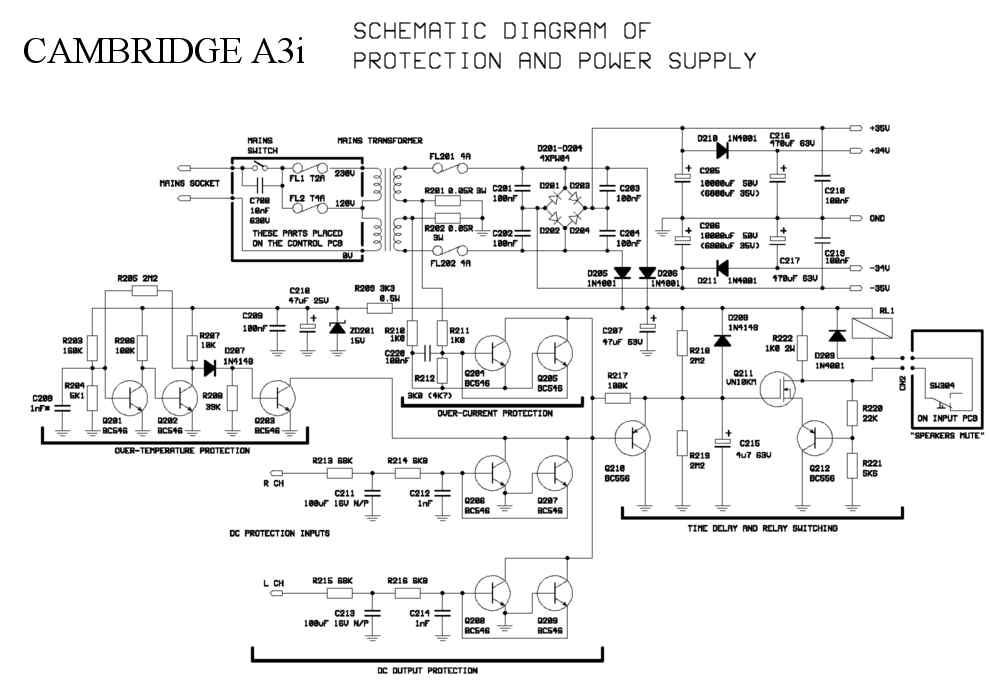

Well, I might take it to richer sounds and see what they say. I've attached a partial schematic, which covers the coil and the protection circuits and the rectifiers mainly. Hopefully the guy who designed this amp might see this... I'll have a search thru some older threads and see if he is still aounrd. 🙂
