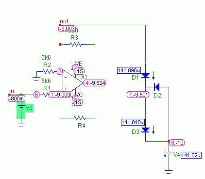

I just listed through a complex 480 pages long book about op-amps, but I didn´t find this circuit.It is shown in few Fender amp schematics, it´s not connected in signal chain, but on the path to CA3080 in compressor circuit.
Can anyone tell me what is it good for, and why is it connected the way it is?

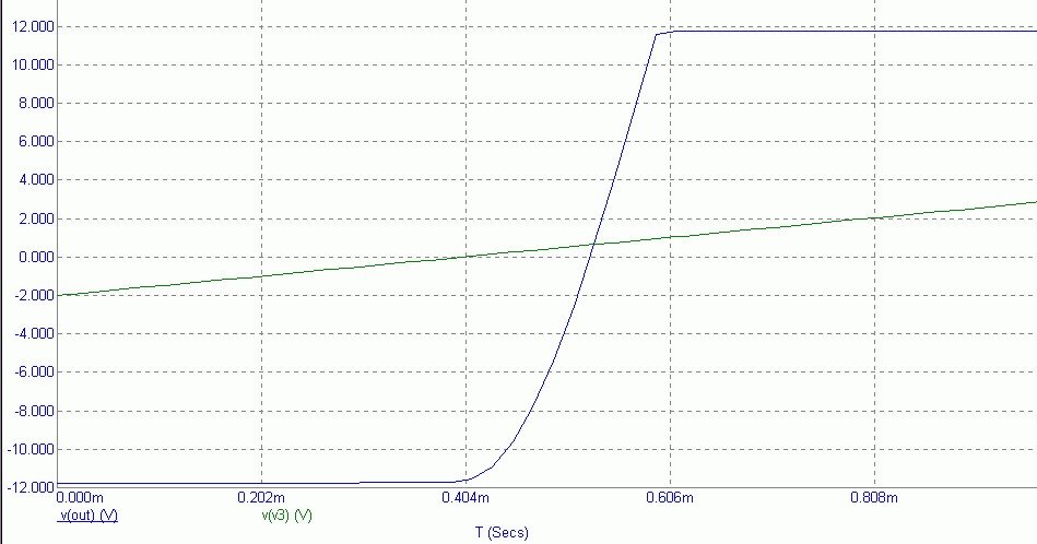

I have also plotted the in(green)/out(blue) curve.

Unity gain, inverting Op-Amp circuit with + & - terminals reversed top to bottom from "common practice".

OK, so what is the gain? (I assumed that with 560 ohms on both the top and bottom, inverting and non-inverting feedback loops, the gain of The Amp would be unity ... granted there is resistance of 5.6K on both inputs, but The Amp is set to unity = 1 = gain. ... Overall circuit might produce something like a negative "gain" of -1.8 to -2.x or more (= -less).
You see the graph, the ouput changes 24volts for cca 1volt input change, that´s a "gain" of 24 (+/- somehting).
I don´t understand this circuit, but I think the ouput product highly depends on input offset voltage.
The output doesn´t depend on offset voltage, nor offset current. Changing R2 changes the slope, other resistors just move the ouput "left/right".

This thing is set up like a Schmidt Trigger .. as soon as the input voltage crosses ~= +0.6 volts (input transistor threshold), it flips over to the positive rail voltage ... and vise versa. A voltage follower with high gain = Schmidt Trigger = a common "flip flop" circuit since the invention of TTL logic ala TRW (Dr. Ramo = the R in TRW).

Where in the circuit is it? What is it connected to? It looks to me that it is amplifying a lot and driving the output to the rail limits with a small input. Almost like some sort of square wave generator.

http://www.fender.com/support/amp_schematics/pdfs/Bassman_200_Schematic.pdf
its on the first page, connected through diode to CA3080.
And x axis on the graph is in miliseconds, the amp does not have so small slew rate, the ouput is a function of input, not time. If you want I can do the analysis slower, like tens of seconds.

A simple latch to "capture" the state of the Mute circuit. ...
Probable: the "compressor" circuit Op-Amp (U14A) "conditions" & isolates the audio signal / information for this Op-Amp (U8B) ... thus The Op-Amp (U8B) "reacts" to the "compressor", latching to either the +VCC rail or the -VDD rail, driving subsequent circuits (U9A & U13A) through diode D27 into a state of "sample and hold" ... for the purposes of controlling whether to mute the whole pre-amp or not ... (Note that U9A is a programmable TTL chip A3080, not a true Op-Amp [or diode], pin 5 is the programming input.)

Muting is done by the few JFETs in the circuit. The U9A isn´t A3080, but CA3080, which is transconductance amplifier - changes gain through pin 5.

So I added the model of pin 5, and things got much more understandable.
This "amp", when provided input lower than 0v, creates adequte current through the diode in bias part of CA3080. On the picture the diode in CA3080 is D3. V4 is supply voltage for CA3080, which is +15 and -10 volts.
I don´t know exactly how, but at least I understand what it does. Thank you both for your assistance.

" ... CA3080, which is transconductance amplifier - changes gain through pin 5. ..." and is thus, for this circuit, either full on (not muted) or full off (muted) ... and, as you note, this is based on the "Overlimit" or not output from that descrete JFET gain stage (Overlimit Inhibit = ~ B6 ~ B7 area of the diagram).
The CA3080 is a normal, "programmable" Op-Amp with a digital (TTL) muting feature, yes, but in this case, the pass through analog audio signal is either allowed or disallowed (muted) = pin 5 passive/normal/"don't care" or activated/muted ... "transconductance" being defined here as "audio pass through" or not. (Latin derivitave: Trans = across, -conductance. ... Almost as bad as German chemical names. 😉 )
