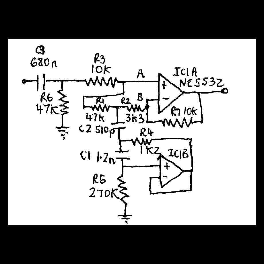

Theres a hole in the response between 8k and 11k which I filled in by using a graphic equaliser type circuit, which I could post if anyones interested. The treble seems to improve with running in.

Yes, I'm interested in the circuit. I can confirm the dip at 9.6Hz, the problem compounded by the peak at 6.5Khz which effectively shows a 9db drop over that 3kHz bandwidth.consort_ee_um said:Theres a hole in the response between 8k and 11k which I filled in by using a graphic equaliser type circuit, which I could post if anyones interested. The treble seems to improve with running in.
I wonder if the boom is caused by air leaking past the phase plug. Since there is no dust cap there is no air seal. Perhaps OB is the best for this driver.
I'm trying to decide on some parallel notch filter values for the 9.6kHz peak and also to flatten out the 700-2k region. The two notches should bring it down to +/- 3db from 60Hz-20kHz or better.
Here is the circuit. Its basically a graphic equaliser circut with a Higher Q than normal. IC1B, R4, R5 and C1 are a simulated inductor or gyrator circuit, and R1,R2 would be the pot in a graohic equaliser. C2 is a 470pF in parallel with a 39pF
I tried other bandpass circuits but they did horrendous things with the phase. With this you can change the centre frequency easily with C2 and the gain peak with R2.
I had to move the frequency up from the centre of the trough so that the filter skirt did not amplify the 7kHz peak, but I ended up with a surprisingly flat response and the phase was linear as well.
You can have more filters by connecting another R1-2,R4-5,C1-2 and IC1B across points A and B and if you make R1 small and R2 big you will get a notch.

In general it is better to flatten the peaks rather than fill in the troughs, although purists might want to do both, so here is the notch filter -
To make a 5dB notch centred on 6.5kHz make C1 2.2nF C2 820pF R1 5.6k and R2 47k
Since the self powered op-amp is not yet with us (I claim the patent BTW) I admit I forgot the power supplies to the op-amps say +/- 12 or 15V
