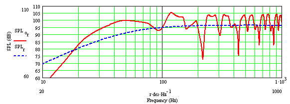

A good idea IMO. For myself, the response doesn't worry me greatly -I've seen much worse from commercial units. A BIB is possible, though it ain't going to be small!. A reverse taper would also be an interesting option. When I'm fully awake I'll look into it.

As you say, simple and cheap to try. The wood is the most expensive part. And if Punkrokr didn't like it, he could pull it apart, use the wood & Beta 12s in the next project and have a great 12" mid to build on.
Might be worth a shot. Anyone know how to model that big enclosure for the Beta 12LTA?

Well now, a BIB is on the cards. The site is at www.zillaspeak.com/bib.asp for those interested -Jeff (Godzilla) very kindly offered to host & design the pages, and GM has quite a few of his variations of this cabinet there too.
For those who haven't seen the BIB before, it's a traditional P.G.A.H. Voigt style chamberless corner horn that vents upward -the top is left completely open, and that forms the terminus. The horn mouth is actually formed by the 1/8 space loading of the room; the reflectional boundary conditions creating a virtual mouth 8 times larger than the cabinet terminus. The idea dates back to the 1930s -probably to the late '20s so high tech it is not, but it is very effective.
1/2 space MathCad FR graph attached. Word of warning: this is a big cabinet. Very big. As they're intended for corners this makes life easier, but they're still not small. Most of the ripple you see in the response will be killed by the room, leaving them pretty flat BTW (true -just ask any BIB builder). No worse than a lot of traditional TLs anyway. Add ~6db to the response to account for room-gain. That means theoretically around 100db efficiency for 1watt at 30Hz, and still about 90db at 20Hz.
Cabinet internal dimensions are 16.5in wide, and (wait for it) 23.5in deep. Add 2x and 3x width of your chosen build material to these for external width and depth. Cabinet is 75in tall, roughly 150in path length, driver 30.25in down from the internal top (point above the driver).
Hope you Like Jurassic Park guys.
Enjoy
Scott

From what I can read the BIB is a compromise by simulating a number of drivers.... from 5" to 8" .... with a fixed length
Are you really sure this will work with a 12"
I am not good in maths ... but dont you get a big change in exstension of the horn when the slanted inner baffle is that much wider in relation to the BIBs with smaller drivers 😕
heres a pic of the size Scott mentioned, with a 12" driver and a tweeter below.(could be above...) The woman is 5'-6" tall
Since the speaker puts out almost 100db per watt at one meter, lets say you want 10 times that for dynamics and you probably sit more than a meter from the speakers..- That means a 20 watt per channel receiver you can pick up for $25 at Goodwill would blast you out of the house. Especially considerig that you would have TWO speakers!
How come other speakers need hundreds of watts?
Well a lot of people actually find large speakers to be a problem, not a cool thing, and smaller boxes are generally less efficient. Luckily you don't have that problem- maybe😉 Also these are horns, or transmission lines or somethin' with a pretty much full range driver.
Some love 'em some don't. I don't think you are so picky that it would matter.. They will have lots of bass and lots of volume and probably sound pretty cool indeed.
