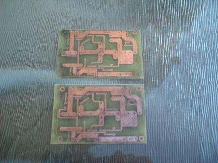

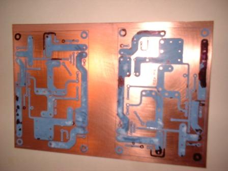

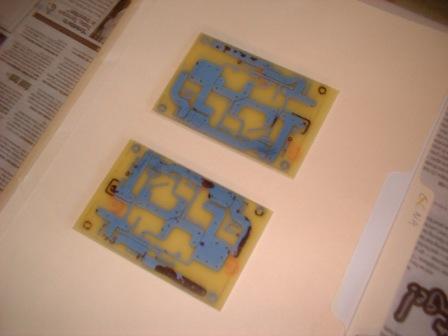

I made these boards with Staple brand Basic Inkjet Photo Paper.
I read about it on the net. http://www.fullnet.com/u/tomg/gooteepc.htm
The board trace is imprinter on the inkjet paper with a laser printer. A inkjet printer can't be used.
Pic od transer with paper removed:

Even magnified your pics, the traces look really good, seems like a good trick.

It's better than the Tech2000 transfer film. I used the Tech2000.
This cost 1/2 of the cost of the Tec2000 and looks better. 30 sheets of the Staple Basic Photo paper cost me $9. It was on sale from $15.
One thing I should have done was keep the iron on longer.
When the paper starts to brown and the edges stick the copper, you're almost there.
It's tough to get the paper off once it's on, but the transfer is strong. It won't come off from scrubbing.

Yes, they are nice boards. I used the ZV9 board as my test because it had a nice reverse image of the trace. It's also the only board I don't have! 😀

Looks really good. Now you need to find a source for super tiny drill bits. That was the tricky part for me. I've made quite a few boards using the "Press-n-peel" blue stuff.
The only thing I would comment is that it looks like you etched away quite a bit of material which "consumes" your etching solution. Next time you may consider keeping that material there, attaching it to your ground plane and only etching away a small (maybe 1/16" - 1/8") seperation around the individual traces. This way you use a lot less of your etching solution. The etching solution becomes less effective with use as the acid molecules are consumed eating away the copper.

That's true Danny. However, I used the trace that was available.
I did cut out the middle part of the copper 1"x4" before etching
The process used about 10 oz. It took about 20 minutes for each board.
