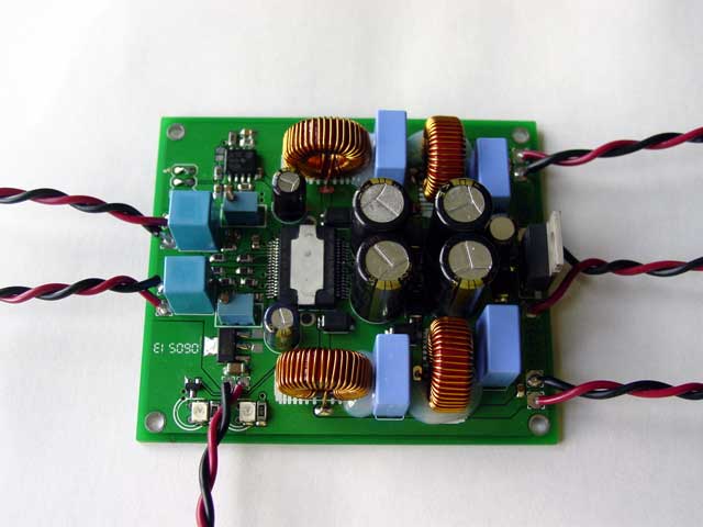

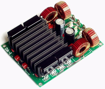

This was my attempt at an amp based on the Tripath TA2021B. I called it the Ref-T for it's over the top implementation of the Tripath chip.

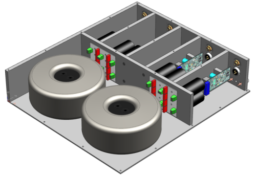

I'll join the gallery too, although I don't have anything yet... This is a four channel NewClassD amp to be driven with an active crossover. It's got 1300VA toroids and separate cap banks for each amp, 15000 uF Jensen 4-pole for the mid/high, and 2x 15000 uF for lows. I'll make the case out of 10 mm aluminium, with 3 mm top and bottom. Haven't desided on front design yet.
With a little luck, I'll have it done by Christmas 😉

What I'd to is turn the supply boards around, it's better to have longer wires to the trafos and shorter to the modules. Also, I wonder if crossover between channels would reduce if you use one trafo per mid/high & bass modules (one channel).
Reactions: Jcris
I know what you mean, but after a lot of thought, I've found this to be the most practical design. This way, I also keep everything AC on one side of the middle divider, shielded from the caps and amp. Also, the wires from the PSU to caps wil be heavy gauge, and only 80-90 mm long. From caps to amp, which is more important, they'll only be 10-20 mm.
I'm not sure what you mean regarding the trafos. I'm running one trafo per channel now, meaning two amps per toroid. I see now that I was a bit unclear on that. They're running off the same bridge (running two bridges on the same secondary is no good), but the high amps are decoupled with 1 ohm resistors, so there's minimal interaction between the two. And like I said, each amp has it's own separate capacitor bank.
Feel free to comment my design, I'm no expert at this 🙂

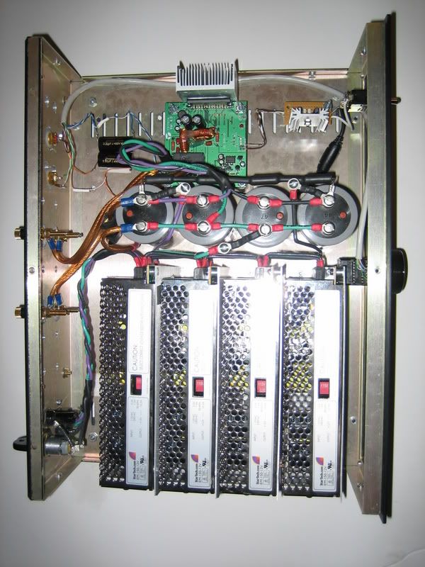

well, here is a recently completed 5-channel UCD amp. this is a prototype.
the finished product.
the guts! 5x UCD-180's, 800va transformer, soft-start module, panasonic power supply caps
the back plate. we are dubbing this one the lily 5.

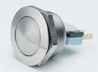

It was the on/off switch on the front I was thinking about. Something like this one would look pretty kickass, or something similar in black.

I do like that push-button switch though. It would look good on another project I'm doing. Can you tell me where you found it?
Found it on ELFA, a Scandinavian electronics shop, so you could probably find something closer to home 🙂 APEM is an international brand, with a big US department, so you should find something suitable here: http://www.apem.com/index.html. This one is from their anti-vandal series 😀
Bulgin is another manufacturer of that kind of switches, but it's British, so I don't know if they have any US retailers.
