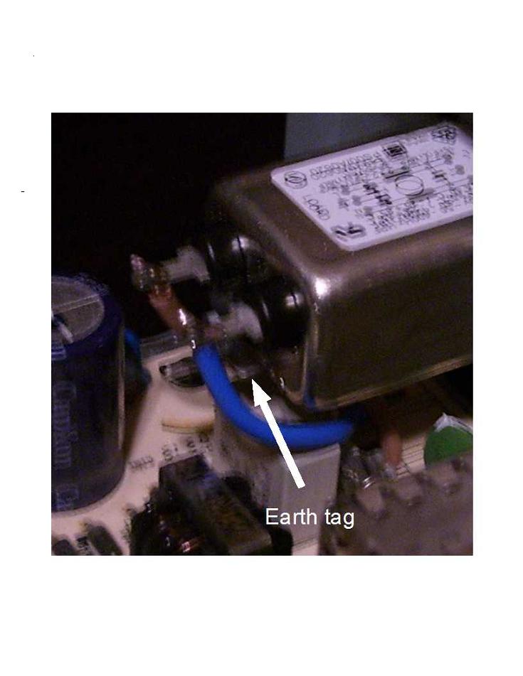

Ive looked all over the net for mods to the Sky box and found nothing. Having looked inside my THompson its clear that significant improvements could be made. Especially the power supply. I reckon if I could find the audio output stage then a change of caps there would be worth it.
Anyone done this or any other mods to the sky box?

I had a quick look.... I'll make couple of suggestions and it's up to you to try... if you want...
1. IEC connector needs much thicker mains wiring - I suggest solid core copper (you probably can't get your hands on silver ribbons?)
2. RCA connectors look good, but the choice of hook-up wiring could be better.... silver plated copper sounds harsh.... better try solid core copper from CAT5 cable (again, if you can't find silver ribbons...)
3. The embedded IEC filters are bad.... really bad! Try without the filter just for fun and see if the sound improves in definition and "spacial" ambient...
Boky
Thanks for the suggestions. I'll give the solid core copper a go cos your right about the sound being a little harsh, mainly in the top end. Theres a lot of detail but its not the smothest sound. Alot better than before, but could be better still.
Theres also an earth solder tag on the IEC but I'm not sure what to connect it to? Any ideas
I'm dubious about removing the IEC filter. I have 4 computers in my home, alot of crap on the mains. Why do you think these filters are so bad anyway?
By the way, Im not sure if I can get Silver ribbon but I know solid core silver wire is available in varying gauges. Which gauge would suit mains and which for the RCA'S?

Using the IEC connector with embedded filter AND NOT connecting the ground pin probably means that you are using only about 50% of filter capability to "alter" the sound.... I say "alter" because that's what they do. They don't improve the sound - only change sound. Find the circuit diagram of a mains filter and see for yourself. Once you figure the above, ask yourself a question: “What if the mains ground is ALREADY polluted?”
The mains filters work ONLY if the mains supply is drawn from a sub-station via SEPARATE feed STRIGHT to the household. Many High Enders pay Energy Distribution companies a lot of money to obtain CLEAN mains (read: clean GROUND as well!!!)
In an ordinary every-day household, it all comes down to power supply sections and decoupling capability of individual Hi-Fi component’s to filter the rubbish from mains. If this is done correctly, the mains filters are not needed and will "alter" the sound in such way that the end result is a loss of space, definition and dynamics... and I have done a fair bit of modifications... proved this over and over again.
The catch is to improve the inner power supply, grounding topology and decoupling FIRST... and then try mains filters.
Anyhow, try it for yourself. If it works for you - GOOD!
They don’t work for me.
Boky

Still no reply on the earthing. Look at the pic here and tell me what to do with the earth pin on the IEC filter:
(the chassis is some kind of steel so its conductive. Do I just run a wire to the chassis?)
