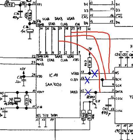

Thank you, aparatusonitus!
I'm working on NOS mod in Philips CD-40 and I was looking for the stupid schematics all over the web.

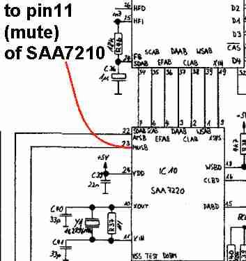

Hello,
I bypassed the output stage after the TDA1541A of my Beogram CD7000 player.
Just for testing, I used 60 Ohm I/V resistors (lower is better as I can read) but now I have this annoying LOUD POP every time I press PLAY.
Tried the mute mod without any effect..
1) SAA7210 leg 11 to SAA7220P leg 23: it does not work
2) SAA7210 leg 11 *floated* to SAA7220P leg 23: it does not work
Is there anything else to do ?
Thank you in advance
