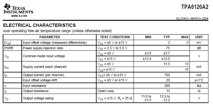

I am CERTAIN this has been covered before, but I cannot for the life of me find the info I am looking for! I am putting together a TPA6120 based headphone amp for a set of Audio-Technica ATH-A900 Art headphones I just picked up. Yes, I know they work fine without amplification, but I wanted something a little beefier in line to drive them.
Anyway, I have a couple of really nice +/-15V 100mA PSU's laying around that I was planning on using with the chips, but the data sheet indicated that at full load they put out 700 mA. Of course this will be heavily dependent on music and won't come anywhere near 700 mA continuous, AND caps will easily handle quick transients, but despite this it got me wondering if 100mA would be enough juice to power the chips.
Is there a concensus on how large a PSU you need to get these chips to behave? Should I double up and give 100mA per channel? (I do have 2 of these PSU's, and I would be more than happy to throw both into this project) Or should I throw in the towel and build a 2A +/- 12V PSU just to be on the safe side? (I know Bob Ellis's PSU from the group buy would be perfect for this)

I attach the basic electrical data for TPA6120A2, from the datasheet:

you should learn how to do the math
amps require some quiescent current – even when not hooked up to a load
beyond that they draw only as much additional current as need to drive the load impedance to the output V determined by their gain times the input signal V
headphones have impedances all over the map as well as hugely differing sensitivity
for the ATH-900 google gives 40 Ohms and 101 dB/mW - the last # could be suspect: sometimes headphone sensitivity is dB/V but mistyped in ads - the 2000 mW power rating makes this error more likely
120 dB is a nice target - for peak dynamic headroom - a average loudness of even 100 dB would lead to hearing loss
100 mWrms power (+20 dBre 1mW) into 40 Ohms is ~70mA, 2.8V peak
on average only 1/2 the current comes from each supply polarity so 100 mA average rating is OK if you have enough C to hold up for the 140mA from both channels peaking in phase at low frequencies - and you have to allow for the TPA quiescent current
with +/-15 V you have quite a bit of supply headroom, so as long as the supply doesn't hard current limit @100mA you could tolerate quite a bit of V droop
on the upside however you don't have much margin with +/-16 max supply V allowed for the TPA6120 - you need to be sure you're not using a unreg supply that could easily be 10-20% high at light loads
regulated supplies can't be just wired together you'd need some current sharing resistors -or you go dual mono which would require 2 separate TPAs
if, as seems possible, the sensitivity is really dB/V then you need lots more current - 350mA peak per channel

Well, my back of the envelope math said so too, but it is good to have a second opinion to make sure that I am not on crack. BTW, these cans are ~40 ohm.lineup said:hi

Of course the first thing I did was read the datasheet, but thanks for the backup in case I was an idiot.I attach the basic electrical data for TPA6120A2, from the datasheet:

Probably! 😀 Actually, the thing that threw me was the datasheet saying it needed 700mA which didn't make any sense to me in light of the load it would be driving. My back of the envelope math said 100mA should be fine. Thanks for the example problem though 😉jcx said:you should learn how to do the math

TPA supply pins are not exactly "independent"
V- are shorted internally and "A" V+ must always be on, with power to the "B " side V+ being optional
combining these constraints with ps gnds connected together and with 2 ps you still want current sharing resistors on V-, probably anti-parallel diodes across the 2 ps V+
you might want to ask on http://www.head-fi.org/ or http://www.headwize.com/ about the sensitivity # for the ATH-A900, the 2000mW max power rating only makes sense if sensitivity is really in dB/V - and then you should want more current and need to set your amp up for higher V gain

That's good to know, and the data sheet doesn't exactly make that clear. Thanks for the heads up.jcx said:TPA supply pins are not exactly "independent"
