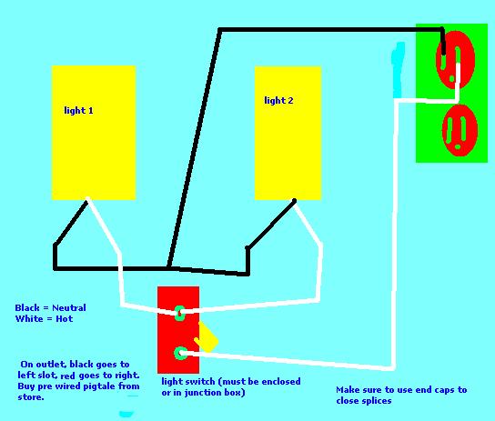

Wow, Thanks for you help. I think I just have about one more question maybe you could help me with. How would I go about positioning the lights. I mean I have the LCD right agaisnt the lens, in a box that is exactly 14 and half inches by 14 and a half inches. Would I angle both lights RIGHT behind LCd or give it a few inches? Do I need a box that big? I had to make a cone out of aluminum foil around a 1750 lumes bulb to fit the exact size of lens/LCD. I shouldn't have to do it again should I? So, in total you recommend at least 12,000 lumes then? I got a few thousand more to go, hehehe. I will take your word and buy those lights tomarrow then. Thanks.

Those lights are very, very bright. They are made to cover 2,580 square feet! I fired up two in my projector box, a wow!!! I was blinded fof a while. As for the angle, you should play around with it. I placed them in the box at an angle like this

I took the plastic shield off both, and placed one in the front of them when they were at an angle. know on my projected image i did have hot spots, but i am positive i made my box to small, and placed the lighs too close or to far (one of the two) from the lcd. If you have this problem, just put a fresnel lens in there. As for 5 fans, i would lay back a bit, The two fluorex lights are not nearly that hot.. i would say to fans topps, but don't take my word on it. Watch a full movie with likt 1 fan, and keet a thermometer stuck in your box. If the temp reaches over say, 120 F, put in a secon fan to blow air in, or out depending. What kind of lights are you using now?

wow... ignore my diagram... it got messed up... I set them up like zark did... Oh yea, these lights will require some wiring. If you go the the elctrical section of hd (i think the lights were in that section too, and not lighting) you can buy a pigtale (premade plug) and a light switch and junction box ( i belive it is called) and make a nice little setup. You may also want to buy shrink tubing or the little twist things to cover up the exposed wire... you get two with each light though. And one more thing, there is a sensor on the light, that will prevent the light from working in the box... The light will go off. I think it is an auto off for when the light is on duing the day. You can a: remove this sensor, or b: put a peice of paper and tape over it.

oh yea, for modifying a backlight, I think leds would be the perfect choice. Any one disagree? There has been a lot of talk if leds will work well for DIY or not, but please keep in mind i do not need a 49,000 lumin lamp using leds... The current backlight on the lcd is almost bright enough to project a 5-6 foot image...
verbose mustafa, you think you can take a few pics of the set up you have? I'm mostly interested in the wiring of the 2 Flourex lights if you can take a few step-by-step pics of those

webcam... no can do... try this... Remember, KEEP ALL CONNECTIONS CLOSED WITH END CAPS THAT SCRew OVER WIRES! The white wire, or hot wire is the one that has the voltage and will kill you when you touch it. The black is neutral and and will not shock you, but I would not push your luck touching live wires (im sure you know this). The left socket on an outlet (US OUTLET) is neutral, and the right is hot. i suggest you buy a premade plug, or pigtale from the home depot (I own stock in them so shop there 😀 ) If you buy a plug with three prongs, Green is ground and is not needed.
Wow! I just got a great idea... Don't put the switch on the hot wire... put it on the neutral wire!!! That way you do not risk electricution (if i spelled it right).
Note by moderator: NEVER DO THIS. Apart from being highly illegal, it is incredibly dangerous. Again, unless you have a serious death wish, DO NOT under any circumstances do as is described in the above post.
Still a little confused.. real pics would help ..i wouldn't be wiring it powered on any way so no live wires.
Sorry, but thats the best I can offer you for now. Try doing a search on google on how to wire lights or something of that nature.
