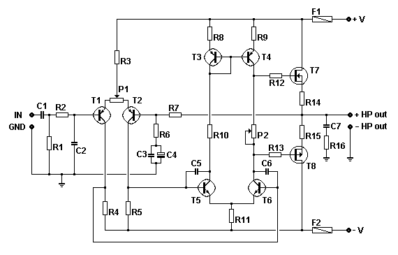

Please comment on this amplifier
Please take a look at this schematic that i found at http://users.swing.be/edwinpaij/ampli_mosfet_simple.htm and tell me your opinion(or anyone in this forum),if it can be work well, at least it seems to be a decent circuit, with more controls to adjust it (I don´t want to explode mosfet´s because are more expensive that the BJT´s).
Even in this page there is an upgrade version of this amp with some components but that.
Also if somebody build it that write a comment
Thanks to all

marito,
you say mosfet is expensive, but according to ur schematic it is also a mosfet amp, I am familliar with that circuit, but I did not build that so far. it is uses a mosfet power of IRFP240 N TYPE, AND IRFP9240 P TYPE
u can visit aussieamplifiers it uses almost same topology.
NO it certainly does not!!!
Anyone using IRFP parts in this configuration will get exactly what they deserve, and that is smoking IRF parts. This schematic is intended for lateral MOSFETs ONLY and is in fact an almost verbatim reproduction of an application note for Hitachi lateral MOSFETs. I am currently aware of only 3 manufacturers of lateral MOS, two being original (Hitachi and Magnetec) and the third, which name escapes me now, being a second source for obsolete Hitachi parts.

The circuit is near identical to the original Hitachi aplication note.
And the 100W kit they used to sell in Maplins here in the UK.
I've had 3 in various bits of equipment, they all expired, presumably
due to unchecked parasitic output oscillations, its not a reliable circuit.
Also its very poor at utilising the full rail voltages driving low impedance
loads, the MOSFETs take up over 10V of swing each, not what you want.
All in all, avoid like the plague, and don't tell me it seems fine in a Simulator.
:)/sreten.
leave P2 in place and add the Vbe multiplier around it.
Remember to also add the cap (100nF to 1uF) across the
multiplier.
Add zener (5v6 to 7v5) protection to the gate/source of the output FETs. Some say this and the existing rail fuses are all one needs to protect the output stage.

Marito said:
Hi everybody, very well discussions!!!
Anyway i want to know if somebody knows the way to replace P2 in the schematic http://users.swing.be/edwinpaij/ampli_mosfet_simple.htm for a Vbe multiplier and his components,PLEASE!!!!
Cheers
multiplier.
