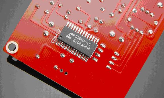

I made a Cardinal Sin in DIY a few days back....I was soldering my new TDA1543 - CS8414 DAC up while EXTREMELY TIRED. I finally went to sleep and in the morning I noticed many of my solder joints were less than Ideal. The tiny solder joints that attached the CS8414 were extremely difficult (while tired) and after a little clean up, they seem fine. After checking for continuity on some of the pins and all of the tracings, I fired her up. I connected the optical out of my Panasonic DVD player to the optical input to the DAC... The DAC can be seen here...
http://us.hifidiy.net/Article.asp?ArticleId=152
I also correctly jumpered the digital input to the Optical In and not Coax In.
Now from what I gather, the CS8414 on this board is connected in such a way that the optical output of my Panny should work - in other words, no Sony/Philips/I2S format issues here...
Anyway, no sound. nothing. Power supply is a 12VDC 1.2A power supply I was using for my Tripath SI. - Unloaded it was 12.3VDC. Center Positive.
I checked the voltage at the TDA1543 pin 5 (VDD) and got 5V, which is exactly what the first LM317 should be providing. I also checked the voltage at both Pin 22 (VA+) and pin 7 (VD+) and they also were 5VDC which are what the other LM317 Voltage regulator is providing, so theres power to both chips..should be good to go here.
There are 8 polyester MKT .1uF caps that I assumed were non-polar, and two Nichicon Muse BP 10uF caps that I again assumed was non-polar, and two 2200pF Polystyrene caps that also were assumed non polar, as they did not indicate any polarity. All other caps were installed correctly.
Without audio input and the 12V power supply connected (LED powers up fine), I measured analog output left/right pins on the TDA 1543 - pin 8 (AOR) and 10 (AOL) and they both read a steady 3VDC referenced to power ground. Pin 7 (Vref) read 2.18VDC referenced to ground.
Anyway, is there any other way I can see if I fried the CS8414 or TDA1545 by checking some of the other pinouts? I have No sound at all - no hum or hiss...I also checked the Coax input with the digital out of my PC Sound Card (Sound Blaster Live) - nothing...

It is possible that you may have soldered CS8414 upside down and since the power supply pins are at the middle it would not cause a short circuit.Just that the inputs and outputs are in the wrong place.Is the notch facing the right direction?; or white dot at pin 1 position?
Check to see if the CS8414 is locking to the signal from the DVD player. Pins 25 and 28 on the CS8414 are both low (0V) when the CS8414 has locked.
Correction - I have 5V on Pins 25/28 when Digital input is not connected, and zero when it is...so we are good here. My previous post was on another set of pins...
I noticed that there are only three pinouts that go to the TDA1543...pins 11, 12, and 26...I was reading the pin voltages on pins 26, 11 and 12 when I noticed I had two different voltages on pinout 12 on the CS8414 chip leg and on the pad...so I looked closer at the solder blob with a jewlers loupe and notied it was not totally connected. So i reconnected them and violla, now it works perfectly. I had thought bad soldering had fried one of the two chips...
