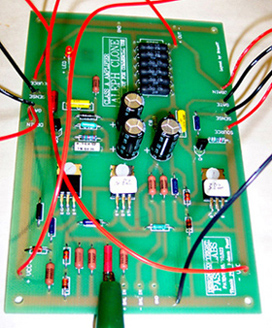

my aleph 2 layout.

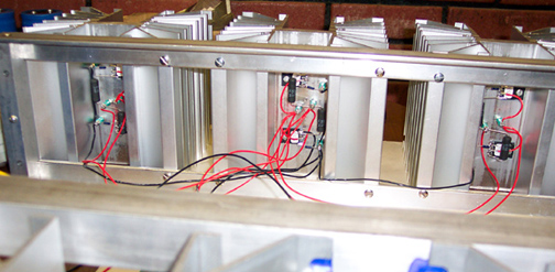

Here are a few pics of the operating Aleph 2 on my kitchen table. Will finish the chassis for both now that this one has proven itmnall out for me.
The voltages all check out fine except for .4 volts across the 1 ohm resistors. The heatsinks actually run only moderately hot. So will crank on the bias tommrrow night and hear the results. The transformer is a 780VA AVEMCO that I got surplus for 12 bucks each. Rails are at plus and minus 43 volts and filtration is by two 56000 @ 63 volt caps per rail that cost 10 bucks each. The heatsinks are new and ran about 20.00 each fomr M&M Metals in Texas. Each heatsink is 5 inches square and 6 inches tall.
Can't say enough good about those guys....so cooperative to the small guy like us and all to reasonable pricing.
All wiring is teflon 18 gauge at this point.
Mark

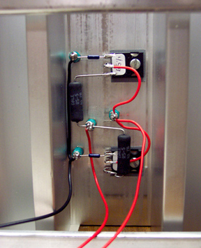

A close up of one of the heatsinks showing two of the mosfets and wired with those neato turrett terminals.
Mark
Looks like quite the monster monoblock. I like the turrett terminals. I will have to look for some. Where did you get yours?
The pcbs look so small next to the huge heatsinks.. hard to imagine that they are 4"x6"...
How warm do the heatsinks run after they have been on for a few hours?
Brian

Look like the temp is around 60 deg. C right now measured on the device itself with my Tektornix temp probe. Its been on for about 4 hours. These sinks work great! Voltage across the one ohm resistors is about a tenth of a volt low right now though so I am expecting a bit higher temperature when I get it cranked up a to .5. I Am going to raise it to .5 volts as per the drawing and leave it there for a while and do some listening. I'll go higher from there after a few days. Right now it sounds really amazing. I've dug out every old mono Jazz CD I could find and listened all night last night. Good mono isn't so bad either. Am driving the amp with my home brew Aleph L.
