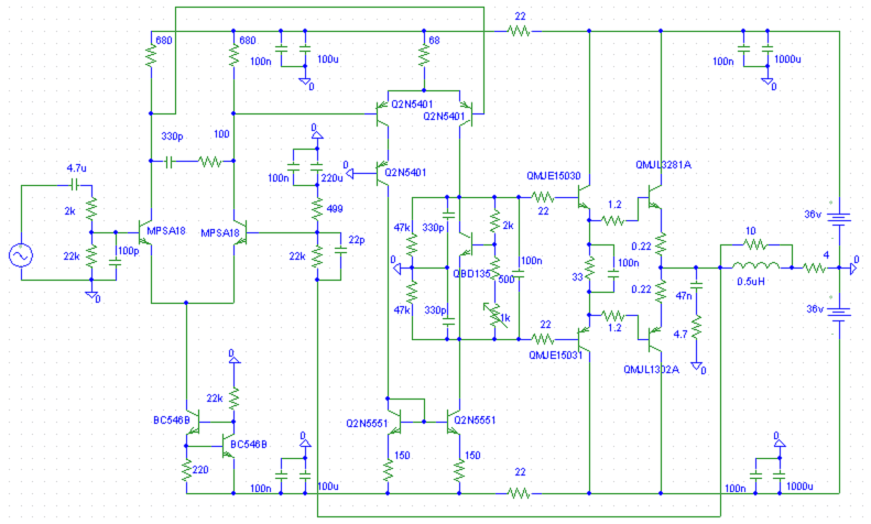

I have been studying the symasym4 design and am wondering a few things:
1: Why is there no bias on the input transistor?
2: Is the 100pF capacitor on the input to filter out radio signals?
3: My simulator shows that the bias on the QBD135 in the second LTP is around 350mV, and changing the POT doesn't do anything, why?
4: My simulations also show a strange wave in the Ib of the output transistors, it seems like a triangular wave subject to extreme crossover distortion. How does this recreate such a clean representation of the input from the emitters?
5: I heard there was supposed to be a miller cap or two somewhere, could someone tell me?
I really don't have a problem with this amp at all! I think it is awesome! I was just wanting to clear some things up before I started to inquire further.
Also, I was wanting a good PCB design so that I could make this amp and experience THE ultimate Hi-Fi home theater entertainment system that will BLOW YOU AWAY!
And yes, I want to use symasm4 because it seems that it is the most liked one (mybe I'm wrong).
My best regards to the engineer of THE ultimate Hi-Fi home theater entertainment system that will BLOW YOU AWAY!, MikeB!
:cheers: :drink: :drunk:
edit: OOP! Forgot the schematic! Here it is:

1, There is a bias, it just works different than you are used to, but is standard for LTPs. Q7/8 form a constant current source, delivering 3ma into the diffamp. R14/29 "hold" the bases at ~0v, giving ~ -0.6v to their emitters. These 3ma are split into 2x 1.5ma through q1/2, creating ~1v across r5/6. This sets the bases of q4/12 to ~1v relative to upper voltage rail. Having the emitters at +0.6v to the bases (emitters up ! pnp devices) the voltage across R10 is ~0.4v, giving a current of ~5.8ma.
2, Yes, the 100pf forms together with r13 a lowpass filter
3, The voltage from base to emitter for T1 should read ~0.6v, if not, the circuit does not work. R23 + R22/24 form a voltagedivider, this multiplies up the vbe from T1. Assuming an open pot (0 ohm), the voltage divider would be 2000ohm + 500ohm. The voltage needed to have 0.6v across the 500ohm would be 3v over both. (0.6*2500/500) This way T1 would keep voltage at 3v. That's why it is called vbe-multiplier.
4, The Ib to the output devices can look very strange, but it's the voltage from base to emitter that count most.
5, Sym4 does not have any miller cap, sym5 does have some kind of one miller cap. (still not a real one)
Keantoken, once you understand LTPs, symasym is quite easy to understand, this might be a good training for you.
As Jan pointed out, the Vbe is not exactly 0.6v, more like 0.65v, somewhere between 0.6v and 0.7v.
And always remember, voltages are relative, they exist between 2 points. Often the 2nd point is simply ground (0v)
Keantoken, head up, as you are really willing to understand operation of an amp in detail you will become once a good designer !
Mike
