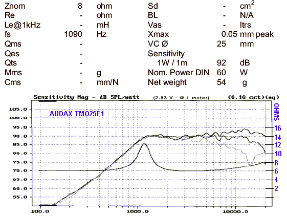

Here is the info and chart on the TMO25F1. The blue printing for the ohms was done by myself. I labelled it to conform to the labelling on the other charts of Audax tweeters. Apparently, Audax just accidentallly left the labels off when they did the graphics for that one particular tweeter.
Note: The Fs of the tweeter is listed as 1090 Hz. the chart appears to be a little off-it shows it as being around 1300 Hz!

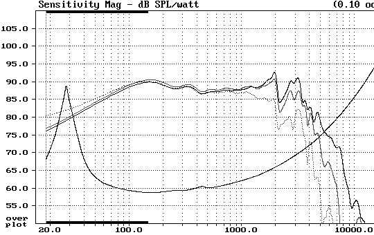

Might as well re-post the woofer for this thread while we are at it. Here is the chart for the Audax AP210ZO.
I personally think a notch filter at 2800-combined with the woofer's natural rolloff-would be the best way to cross this woofer over at 2000 Hz, but any suggestions from the rest of the forum would be indeed welcome.
Here are the Thiele-Small numbers for the AP210ZO:
Fs = 29 Hz
Vas = 92 liters
Qes = 0.36
Qms = 3.48
Qts = 0.32
BL = 8.1
Re = 5.3
Le = 1 mH
Xmax = + or - 2.6mm
S = 227 sq. cm
SPL = 89.5 dB

François seems to think that this tweeter and woofer combination isnt a good one. Is he right?

I would disagree with Francois, although I understand his philosophy. There is a school of thought that says that two drivers crossing over should have relatively flat response for an octave past the crossover point. Then the electrical components you insert should be responsible for the various slopes of the drivers around the crossover frequency.
The other school says that is alright to use the natural slopes of the drivers in your crossover. You will notice the original AR woofer you originally had in there had no inductor or capacitor attached to it. AR simply used the woofer's natural rolloff. That is what we are trying to do once we knock off that response surge around 2800 Hz. Knock that off, and you have a woofer rolling off at 2000 Hz.
The other thing Francois was probably referring to was the fact that it is a rule of thumb that you should cross over a tweeter at least an octave above it's resonance frequency. The chart appears to show the tweeter's resonance at 1300 Hz, but the resonance is listed at 1090 Hz. Other Audax tweeters have a 1090 Hz resonance as well. An octave above 1090 Hz is 2080 Hz, and 2000 Hz is certainly close that.
I have crossed tweeters over less than an octave above the tweeter resonance, and it came out alright.
I will not disagree completely with Francois, because if the question were: if you were an engineer and had to select speakers to make a run of 1,000 pairs, would you select these two units? The answer there would be: probably not. But the issue here was, given a certain amount of money, can we buy two units that will give us decent, hifi sound? And the answer there is, I believe, that these units will deliver that. These were about the only two units you could afford, and I believe that can be made to work together without stretching things too much.

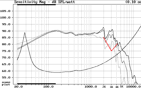

As you can see with our Audax AP210ZO woofer, it begins to roll off sharply at 2000 Hz, then surges up around 2800 Hz, then rolls off naturally again. A notch filter will knock off that surge, and we can have a woofer that acts like it rolls off naturally at 2000 Hz.
The picure below illustrates. The red line i the response of the input signal going through the notch filter.
I am trying to find how the notch filter at 2800 affects the phase of the AP210ZO at 2000 Hz. There are programs that will tell you, but I can't seem to get them set up.
We have such a program, written by a member here, that tells you, but I have to figure it out. Let me figure this out, and get back to you , hopefully in a day or two.
Below, superimposed over the AP210ZO response curve, is the action of the proposed notch filter, illustrated in red. They are simple to build, I just want to get some phase information.
The output of the speaker will be midway between the response curve in black, and the filter in red.
This should give us a woofer with a resonably workable, though not perfect, rolloff around 2000 Hz.

If I'm not mistaken, you (kelticizard), want to smooth out that bump in red. But, aren't notches used for bringing down the bump in frequency caused by driver resonances? Also, Crossover around 2000Hz, or 2800Hz, you'll be fine. I crossed my TW010E1 (Told you, it's a 'budget' system), at 4000Hz. The fs of this driver is 3000Hz, making the desired point 6000Hz! (Not sure if the rule is above..or just an octave away) or, 1500Hz. Well, at 6000Hz, sounds were becoming harsh and piano frequency response ends around 3600-4000Hz, so, 4000Hz was the decision, but enough about MY system. Honestly IMO, point would be somewhere before 2000Hz, or maybe 2000Hz. However, I'd also smooth out any bumps in the response from this.

If I'm not mistaken, you (kelticizard), want to smooth out that bump in red. But, aren't notches used for bringing down the bump in frequency caused by driver resonances? .... I crossed my TW010E1 (Told you, it's a 'budget' system), at 4000Hz. The fs of this driver is 3000Hz, making the desired point 6000Hz! (Not sure if the rule is above..or just an octave away) or, 1500Hz. Well, at 6000Hz, sounds were becoming harsh and piano frequency response ends around 3600-4000Hz, so, 4000Hz was the decision, but enough about MY system.
A) Are notch filters used to smooth out the bump in driver resonances? Yes. And I would say there is a rather big bump at 2800 Hz. Hence, the notch.
B) "but enough about MY system." There is nothing wrong with talking about your system if it is relevant. In this case, it is. You said that you got good results crossing over near the Fs of your tweeter-not an octave above-and that was mentioned as an issue in this thread.
C) The TW010E1 might have been selected by you for it's cost. However, it's .4 inch, (10 mm) diaphragm would make it a good choice for anyone who wants good dispersion above 12,000 Hz, regardless of cost. What was the size of the driver that crossed into your tweeter? Generally, "beaming" is what causes harshness, and too large a driver for the frequency causes "beaming". I would think that for a 6,000 Hz crossover to be used, the midrange should be five inches or less-preferably less.

Yeah, I agree with kelticwizard but I am afraid that the normal rolloff curve of the driver introduce distortion and affect the sound. I have never tried this so who knows if you can get good results.
I have heard of several respectable speakers that use the natural rolloff of the woofer, without an inductor, as the crossover. The AR 18 BX, which is the box that these components are being mounted in, used that system-no electrical crossover components at all in the woofer circuit. And AR is a good brand, especially considered so in the early seventies, which is when these were manufactured.
Of course, these brands that used the natural rolloff did not use notch filters to suppress peaks in the rolloff area. That is what we are going to do, and yes, that makes it unique.
I think the idea of using the natural rolloff was used more in the sixties and seventies than it is now. But with gradual slope crossovers coming back from the seventies, why not this, LOL?
The notch filter is resistive, therefore in phase, at the notch frequency. It is the phase of of the frequencies around the notch filter's center frequency that I am concerned with.
Audax has a home theater system, designed by Joe D'Appolito, which features this woofer's little brother, the AP210, with a notch filter to smooth out some peak in the response. However, I don't think the peak is in the crossover region. Ours will be, unless someone has a better crossover.
Frankly, with the notch filter beng resistive in the notch frequency, I wonder if doing this way might not be an improvement over the normal crossover. It is a possiblity, I would think.
