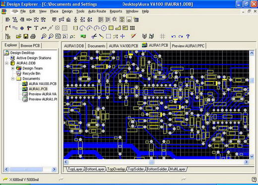

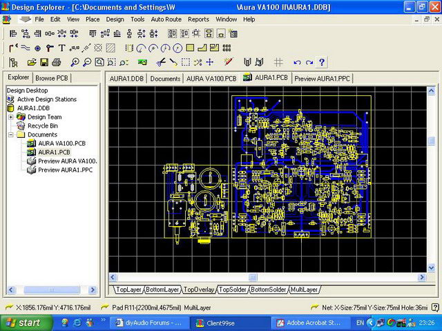

I bought it from my friend him told me that it's a best of integrated amplifier '96s.
I already received its PCB from R&D shop, they ask me for 100USD !!!
Hope
analog guy

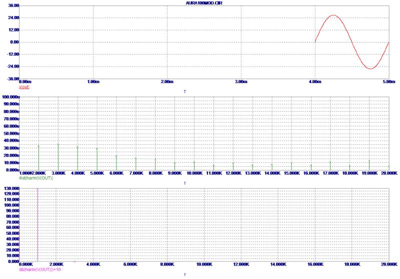

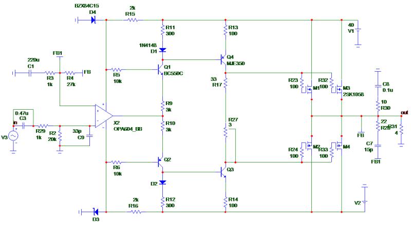

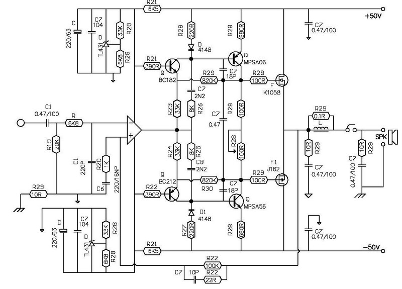

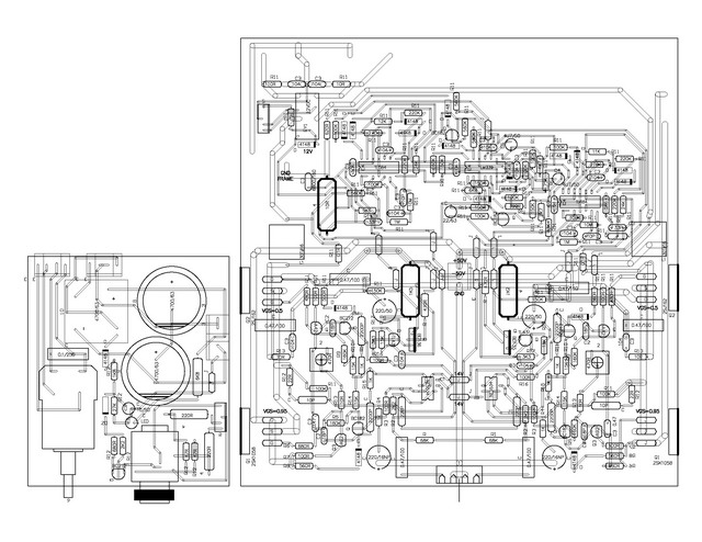

Constant gain & protection !
2*TL084 for constant gain amplifier and 1*LM339 for input : output gain comparator.
TL084 used for special calculate voltage gain (AV) of amplifier when used with vary impadance load output (hard to drive speaker) on the circuit you can see only RF/RI for calculate AV but this IC are special more than typical amplifier !
LM339 used for comparator INPUT : OUTPUT voltage when there're some problem with output such as shorted output relay was disconnect from LM339 function, Vo/VI not equal in same dB
Example
MAXIMUM OUTPUT : INPUT = 30V : 1V = 29.54dB = NORMAL AV
SHORTED or LEAKAGE OUTPUT: INPUT = 0V : 1V = -INFINITE dB relay will be disconnect
Regard
Analog guy

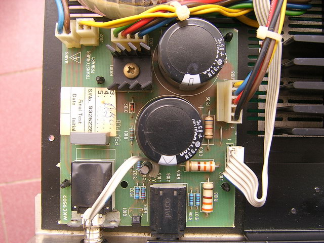

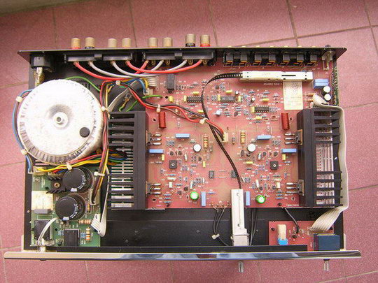

I own one of these Aura amps. There is a problem: the servis guy who has repaired a problem with source selector (it is working now) didn't have a spare part for another problem. So he bypassed something that stabilize amplifire (when I turn it on) before the signal comes to speakers. The result is when I turn it on there is a loud crackel in speakers even if the volume is set to minimum. Which part did he bypassed and where can I get it? Is there a substitute for this part? I can take a picture of interior of Aura if necessary.
Thank You
Thank You
Possibly the protection circuitry.
