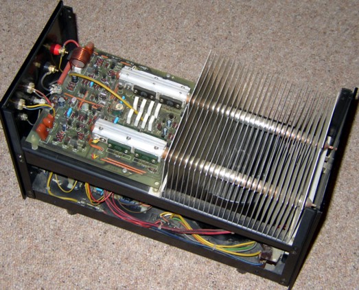

Stax Da 100M
her pic of the Da 100M:
Alex

You can see from the picture that the DA100Ms were designed for electrostats.
In those days it wasn't that easy to find an amplifier that could handle ESLs, most couldn't.
And most of the ones that could did not match well, ESLs overemphasize the weaknesses of an amplifier.
Most tube amps were not strong enough, and the ones that were had a shocking price tag.
A lot of the SS designs that could had a price starting at $10,000

I suppose it's because of the overcautious design of the DA100Ms, the horrid output coil and the V/I-limiter.
But don't you love how they look: a totally different and very modest design, novelty output devices in those days with superhigh Ft and heatpipe cooling technology.
State of the Art.

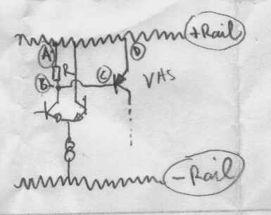

I'm not sure about this, but I think that what makes the amp has 155dB S/N ratio (input equivalent noise : less than -125dB) cannot be separated from the good regulators for the front end voltage supply (CCS+Zener+Transistors).
Raise one question : What's wrong with ordinary VAS?
I've seen that +rail and -rail are not pure DC. They are disturbed, like sea waves, following the music.
When bass notes hits, the supply will dips.
But if we see the schematic, even if +rail and -rail are dirty like sea waves, what's driving B-E junction of VAS transistor (point C towards D) is actually the voltage drop of the R (point A towards B).
If A-B is fluctuated by the seawave, so does point C-D. If both the driver and the driven has the same fluctuation, they are common to each other, current flowing from VAS collector will not be affected.
What's the truth about this. Folded Cascode VAS > differential VAS > singleton VAS (ordinary VAS). Are these 3 in the right position when it comes to the question about PSRR for VAS, from the most good PSRR to the worst PSRR?
Is that Folded Cascode VAS referenced towards ground (Like this STAX patent) is really better than ordiary VAS?
