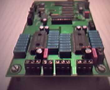

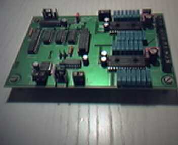

Look what i got for Christmas.. Can't wait to put some juice on it.
Greetings,
Guido

Looks are really nice indeed! But that doesn't count...
Sound..? Don't know yet, first need proper power supply,
proper output stage and a proper way to get i2s from cd
player to dac (and the clock reversed). So that is still
a long time from now.
Schematic..? When all works well, i'll post it. It involves programmable logic (GAL20V8).
First i need to do basic testing, for that i am still waiting for one
component..
Decouplingcaps are 0.33uF Siemens polyester film, but there
is room for other types (but not the megahuge types). I don't know your experts, but
other experts think the wima mks 4 is not so good. Than again, i am not an expert.
Had some request already for pcb's.. When all works well, i am going to see if i can
have other people order directly from the pcb factory. I paid 39 euro, but it will be less
for others (films are ready). You have to be patient there. If you are interested, you better
start looking for a GAL programmer. I have one, that's why i am using it.
Guess half the pcb could be used to sent 'mono' I2S to other DAC's. Using a saw is all it takes..
But only non-os, otherwise the freq will be to high for the dig. logic (4517 is slow).
Or put two dig filters behind the splitting part :->
More to come in the future.
